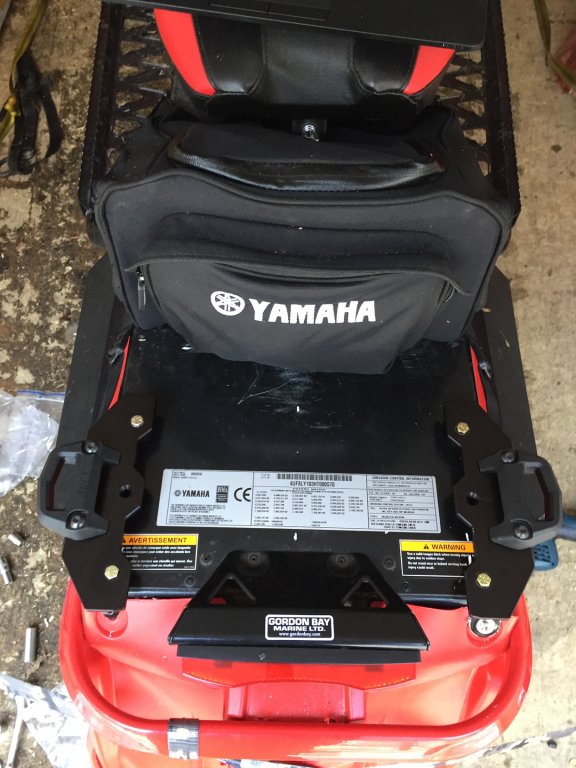

some pics off my old sled. used hinges available at home depot for easy on-off attachmentHere's my solution...3 gallons total, can still run a tunnel pack. Attaches to the bumper.
