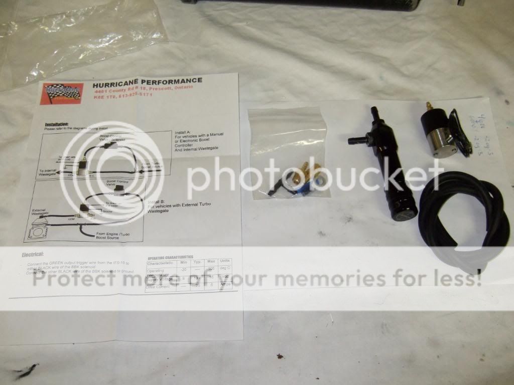

Bountyhunter - I run the same setup as you but I have a failsafe solenoid to bypass the boost controller when meth flow gets too low, this way I can continue to run the sled at wastegate boost setting which is safe on pump fuel.

rxrider said:Bountyhunter - I run the same setup as you but I have a failsafe solenoid to bypass the boost controller when meth flow gets too low, this way I can continue to run the sled at wastegate boost setting which is safe on pump fuel.
...Absolutely,your Output fluid line runs from your tank to your pump to your Solenoid, then through it to your Nozzles tapped into your intercooler. and your power line runs from the Solenoid back to your Injection Controller. I actually like that system as it's very simple and works well.
My Fail Safe Monitoring System hooks up exactely the same way other than my lines go through my Fail Safe Unit rather than a Solenoid to my Injector Nozzles.
But here is were the real differences are when the system triggers a low flow below the set limits....
#1...It will reduce the timing with a igntion/timer controller, such as a MSD.
#2...With a after market engine computor [ECU] Can bs set up for a less aggressive tune.
#3...A relay to be used with turbo engines equiped with a stock boost control bleeder valve. When the IFS unit activates the relay will open to disable the bleeder valve, allowing full boost pressure to the turbo waste gate. This will limit the maximum boost pressure of the turbo to that set by thwe waste gate springs.
#4...is the same as yours as my Fail Safe Monitoring Box hooks up to my Injection Controller which hooks up to my Manual Boost Controller allowing full boost pressure to the turbo waste gate and limit the maximum boost pressure of the turbo to that set by the waste gate springs.
My system came with the IFS-10 that's why I'm running it at this time.
Considering that this whole system was designed for a auto, it has been adapted to hook up to our sleds....Pretty Cool Hey.
