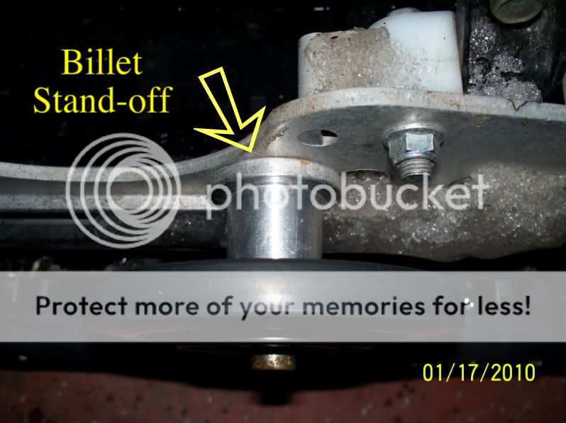

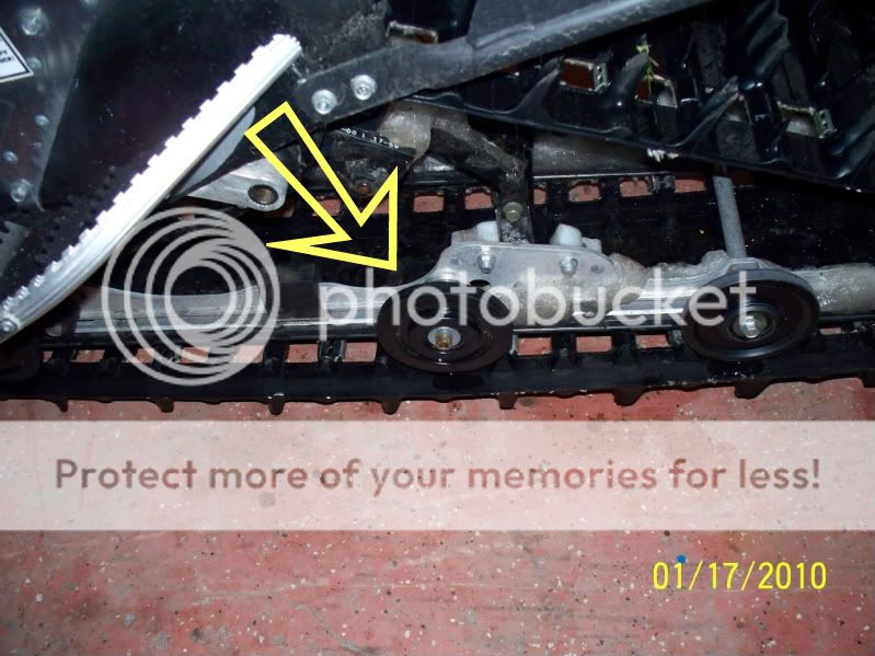

I just ordered up all the parts to add extra 5.25 idlers to mine. I'm mounting them just ahead of where the rear sissor arm
mounts to the rails. My first set of slides are wore the worst from the area to the factory mounted rear 5.25 idlers. I'm going to do a post when I mount them with pictures and such. I used all yamaha parts and it's costing me 130$ total for all the parts shipped.
Here are some pics of what they did. They also replaced the front idler wheel with a bigger one.
thats EXACTLY where I'm putting mine when I get the parts in. I ordered the factory stand-offs seen on the rear wheels in your picture along with the Idlers, bolts, nuts, and washers for the front idlers. The most severe wear on mine is right between those sets of idlers in you picture.
thank a lot Jonny! Thats right where I was thinking about mounting one but if I mounted on up further I would have to go with those little ones yamaha sells. If it helped you Im gona definately try it, I have vertually no wear in 500-700 miles on my last 2 sets of slides other than right in the back there, but I bought my sled with extra wheels way up in the front of the skid.

your track is mint , i swaped over to the challenger track and added extensions , but i had 5000kms on my maverick track , and it was curled over bad . 151 and 2.3 inch lugs makes the difference on this sled .
