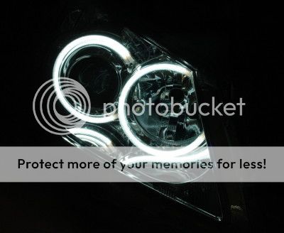

I thought about including CCFL "Angel Eyes" in my retrofit but decided against it.
Angel Eyes
I didn't want to have to deal with potentially reopening the headlight housing in case one of the CCFLs failed. I'd rather try to keep it a once and done kind of deal. That, and like you said, the only place an observer would be able to notice it is if it was parked outside a tavern or something with the angel eyes turned on, which my sled never is.
Regardless, angel eyes or not, this upgrade does increase the BLING factor.
gun nut said:I have the multicolored prism around my bulbs. Really look cool, but go unnoticed to most observers.
Angel Eyes

I put the CCFLs on mine and I didn't have a problem yet in 500 km. However, if I had to do it again, I'd go with Morimoto XB LED angel eyes as they are more reliable and have less stuff that can fail.
Snowmobileaddict said:gun nut said:I have the multicolored prism around my bulbs. Really look cool, but go unnoticed to most observers.
Angel Eyes
