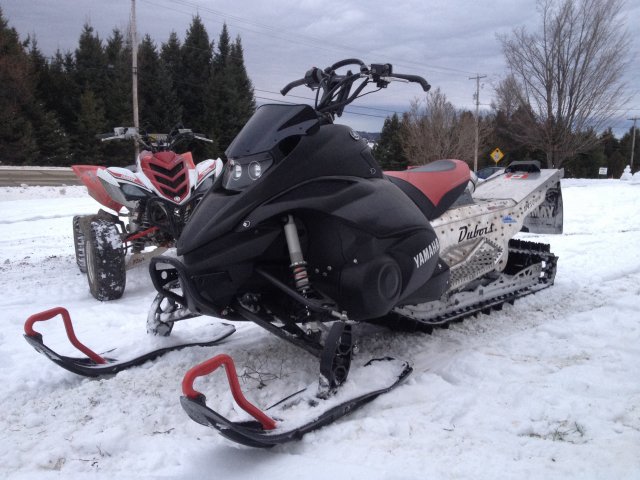

Looks WICKED!!!
Old friend had projectors in his Phazer. Couldn't see a single thing at night. Paul, had a black and green Phazer awhile back.
Is there better light output this route?
I have been looking into this as I do ALOT of night/evening riding. 2 adds on Kijiji in Wpg i have on my watch list.
Been reading up on them a little bit.

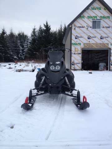

I have the 4500k in my Phazer and i'll be installing the same set in my Nytro and my Dad's Apex. It's the best mod i've ever done to a sled considering how much night riding I do. I can ride behind someone and outshine their headlight.

How have these held up over the last couple seasons? Any burn outs? Left you on trail in the dark or anything?? I do tons of night driving and I'm seriously in need of something brighter. Also, am I safe to assume the projectors throw the same amount of light but are less annoying to oncoming traffic like just putting hids in place of the bulbs??I don't think there will be any heat problem. These projectors use standard H1 HID bulbs and the hi/lo shield (bi-xenon) is operated by a small solenoid. They don't produce any more heat than standard HID bulbs. Many people use these projectors to retrofit even smaller sealbeams so I don't expect any heat problem.
UNSC_WARRIOR
You are right, the projectors are way less annoying to oncoming traffic as the "cutoff line" is very sharp which allows you to aim them at the right height. They throw way much more light on the trail as the light output of HID bulbs is much higher and the projectors distribute light much more evenly. I will try to take output shots and post them here.
As for the reliability of the setup, I have had some problems with the relay that switches the lights on. It wasn't properly sealed and ended up freezing, leaving me with no lights. Problem was however easily resolved by replacing the relay. I didn't encounter any other problems and am still enjoying this setup as of today! No burn outs, no flickering, no nothing else!
