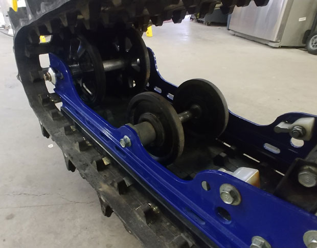

when i converted my 09 rtx into an xtx rear suspension i used a kimpex kit for adding wheels and axle to an older enticer suspension that i modded to go in between the rails instead of the outer wheels. it held the plastic off of the floor about 1/4" and the slider wear looked good at the kick up the last time i looked at it. without them i bet you will wear through.
I am curious about this. I dont want to sink any more money into this skid to be honest, but I am open to ideas. I thought about adding the wheels that normally go on the front of the rails to the inside where that x-bar is, but thought that having the crossbar was more important. and am ASSuming the wear will hit a certain point and just stop?
Well after the slides wore through on that spot on my apex xtx in that spot with wheels, I was reluctant to run without anything there. To me it did not matter if they were on inside of rail or outside as long as they where there. Here is a pic with skid 1/2 in sled.
https://ty4stroke.com/threads/rtx-to-xtx-conversion.150848/
I cannot remember what I cut off of both ends but I did get the holes in the end of the shaft re sized and tapped to match the holes in the rails. Here is part # I used from royal distributing but it is available from any kimpex dealer shaft # 04-429-04 and then I used 2 kimpex wheels # 04-116-95p. Just missing the snap rings to hold in place on shaft

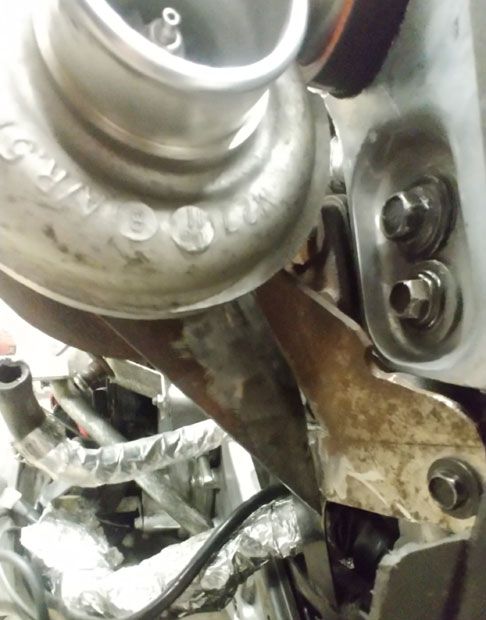

I finished tacking up the turbo bracket as best I could with a possessed welder. There must be a short somewhere inside the line or gun, because the wire would randomly start feeding even without me pulling the trigger, and wouldn't feed when I would pull it. As you can imagine this made it very difficult. I did the best I could and then I ran it over to my buddy where he was able to weld it up. While he was doing that I cut a notch into the intercooler, and he tig'ed that up as well.

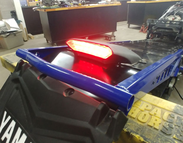

I ended up picking up a Nytro tail light months ago because once I removed the taillight from the shroud, I saw it was cracked. The Nytro tail light came with the trim ring, which worked out perfect to mount it to the rear of the tunnel. I plan to run the wires in the tunnel in some conduit and pop up under the seat.

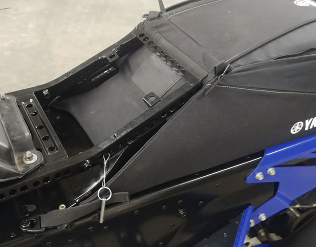

A friend stopped over the other night and we make a quick disconnect seat with some 1/4" x 1.75" pins. This will allow me easy access to the PCV usb that I ran back near the fuel pump, which I intend to throw a USB cover over. The orange string is just a test to see what options we had for keeping the pins from being lost. I ordered up some 1/8" stainless cable, crimps, and a crimping tool to make some permanent keepers

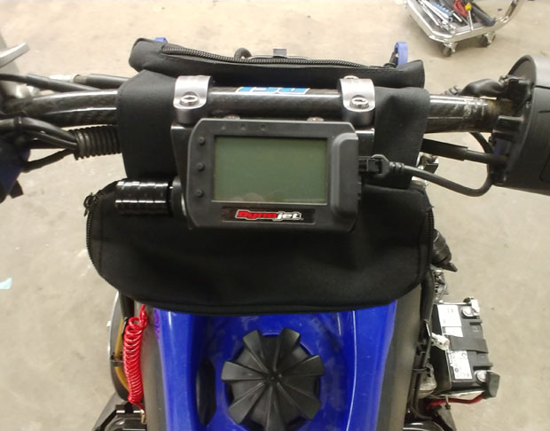

I was going to cut the plastic over the tank to mount the Hallman Pro (ceramic ball) MBC. My buddy had a better idea. We installed it under the POD. Also pictured is a cheap Powermadd handlebar bag I picked up a while back. I am waiting on vacuum lines that I ordered before I can finish the connections.

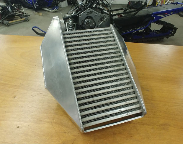

With the boondocker kit having the oil can located under the intercooler, priming the oil pump is a pain! Considering there is a chance that the pump could loose prime, which would cause me to have to remove the intercooler to prime, I contacted Four Stroke Solutions and @Mtnviper let me upgrade my kit from the standard version to the Premium version with the ROVCM and Quick Prime features. Being able to just hold down a button to prime the oil pump is invaluable to me. If any others out there are considering a ROV kit, dont make the same mistake I did. Just order the Premium version with Quick Prime the first time around.
While I am waiting for the Quick Prime kit to arrive I tackled a few small items. I got out to the shop late tonight, but was able to get the tail light fully installed. I was wavering on what I wanted to do for routing the wires, but I ended up just picking the in-tunnel option. I had some light, thin gauge aluminum tubes from an old screen tent that worked well. I riveted some hose clamps to the tunnel, tossed a thin coat of black on the tubes after cutting them to length and drilling holes for the rivets to poke down into, extended the tail light wiring with some solder and heat shrink, and I can finally say the tail light is done.

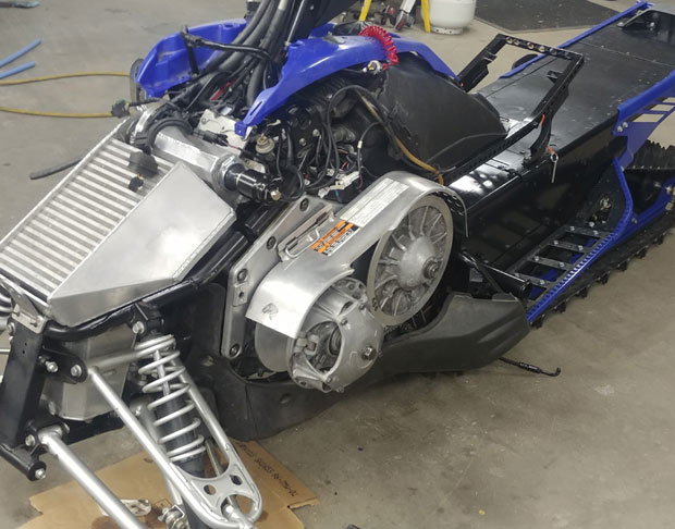

Does anyone have any thoughts about how to seal off the areas highlighted in this image? It seems that these areas would just pack with snow, eventually melt, and turn the phazer into an ice block, as well as potentially get into the clutches. I was thinking about picking up some door/window gasket material to seal between the cooler and the frame rails, but I am not too sure about what to do for the large gaps around the intake area.
I'm open to ideas

I still have no idea what to do about those giant gaps. I'm guessing that no one else does either, or maybe the site activity died between Tom having to kill Tapatalk and the season coming to an end?

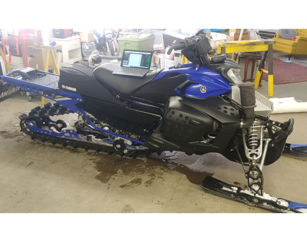

I created a basemap to start with the tuning. It was a nice warm day here in MN so it was perfect to open up the garage door and fire up the sled. I connected the PCV to the tablet, loaded up the map,and gave a it quick rev-through prior to taking it out on the lake to do some tuning. Thats when I experienced another set back. The 02 sensor is shot. It refused to move from 14.8 no matter what settings I loaded into the PCV. Plus, the exhaust smelled like it was too rich. 14.8 isnt exactly rich. Maybe its the Torco, but it just didnt smell right.
The replacement for the wideband 02 for the AutoTune module is just a Bosch 17205, which can be bought online all day for 60-80 bucks. However, I was running out of time so I called a few local auto parts places to see if I could get one sooner. The soonest I could get one was the next day, but it set me back $115! At least it has a 12 month warranty.
While I was waiting for the 02, I installed the mounts for the tail bag and made some keepers for the quick release pins on the seat out of some stainless cable and crimps. Then, I played around with some under seat storage options for the 24oz bottles I ordered for the Torco (what I need for 96 octane in a 7 gallon tank of 91)
When the new sensor came in on Saturday I got it installed and was able to see that I was actually sitting around 12'ish for AFR at idle. I made a few revisions to the map via autotune with the rear of the sled on a saw horse. I took it for a drive around the back yard, which was the first time I have ever even drove the sled. According to the PCV, I was only able to hit 2lbs of boost in our small 1 acre yard but it was still a blast to drive.

Looking good Tom
Not sure what to do with the gaps other then maybe some Gorilla tape as a temporary solution. It wouldn't be pretty, but it may keep the snow out for your trip until you can come up with a more permanent answer.
Possibly fabricating some small panels out of aluminum or Black plastic. Either way, it sounds like a good summer time project at this point!

Hey DF the machine is looking GREAT! Sucks that you're having those PITA setbacks. Here's a couple random thoughts.
Is that a phazer secondary on there? Sure looks like it. It probably will not stand up to the power of the turbo for very long.
I agree with Mtnviper about fabing some aluminum or plastic covers for the area in question. It might help if you could post a pic of that side of the sled with all the pieces in place (headlight, plastic, ect).

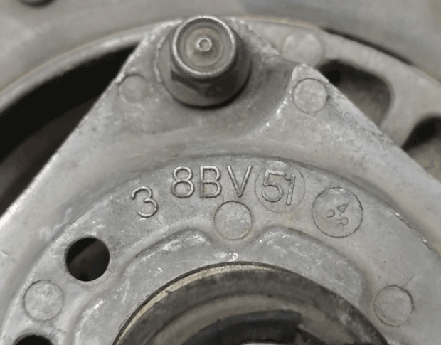

The sled came with an extra secondary. The PO said he thought it was off of a SRX.
I havent had time to dig into it yet.

It runs Nice work!! I've been meaning to swap the newer secondary into ours but haven't gotten around to it. Maybe this summer. As for those gaps, I've yet to have any problems with snow getting into them. Obviously your results may vary, but she's had it in 50 degree mashed potato snow, feet of real snow, and everything in between without any issues from snow ingestion in those gaps.
kallholmen
The SRX secondary is probably a better choice. Might need some machining though. The C-clips in the original can break. I'm running a secondary from a v-max.

I would buy som clay an make moulds for glass fibre to seal of gaps. Or just seal it of with mesh and Velcro tape.

I guess I will take it on this trip as-is, packing plenty of tape and see how it goes and decide what to do about those gaps later. I am much more concerned about my clutching and tuning situation right now, with clutching being my utmost concern. Worst case, I can go out there and spend some time with the auto tune getting it dialed in a bit closer.
The clutching kinda has me freaking out. I didn't replace the secondary circlip with a new one after taking it apart to clean, and while trying to research the SRX secondary, I ended up coming across so many posts saying the stock clutch circlip HAS to be replaced and can let go causing all sorts of damage. I dont know how I missed that, but I have never seen anything about it before. Now I am even more anxious about this sled.

kallholmen
The C-clips CAN break on a stock machine as well. I actually can't see why higher horsepower would make any difference for the performance of the clips? If I was in your position I would pack the other stock secondary to (you had two, right?) and just go. I've heard that Yamaha made some improvements on the plastic clips over the years but how and when I don't know.
Change to a safer setup when there's time.
