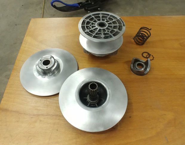

I actually have 3 secondaries. One from this machine, one from the 08, and then that SRX one. The 08 circlip looks bad, one of the ends wasn't cliped into place. I ended up taking it off to pull the spring to see if I could use it in the SRX secondary. The primary that is on there now appears to have a clutch kit in it. The weights look like supertips, and the spring isnt stock. I ordered another clutch kit from Thunder Products to toss in the other primary as I do not have any of the weights to adjust the supertips kit. Seriously, Lonn at Thunder Products is one hell of a guy. He went out of his way to do a bunch of research before sending me a kit.

In the meantime, I made some forward progress. If I am going to be stuck with trying to do the tuning myself, I need to get the machine movable. The clutches it came with were horribly dirty, It took hours and hours of scrubbing and 5 cans of brake cleaner to get them tolerable. I have a new Gates CF belt, as well as a brand new OEM belt for a back up, that I need to wash before I can install one of them

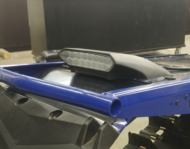

I ended up picking up a Nytro tail light months ago because once I removed the taillight from the shroud, I saw it was cracked. The Nytro tail light came with the trim ring, which worked out perfect to mount it to the rear of the tunnel. I plan to run the wires in the tunnel in some conduit and pop up under the seat.

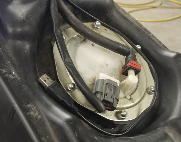

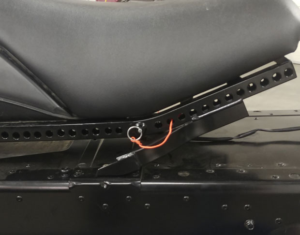

A friend stopped over the other night and we make a quick disconnect seat with some 1/4" x 1.75" pins. This will allow me easy access to the PCV usb that I ran back near the fuel pump, which I intend to throw a USB cover over. The orange string is just a test to see what options we had for keeping the pins from being lost. I ordered up some 1/8" stainless cable, crimps, and a crimping tool to make some permanent keepers

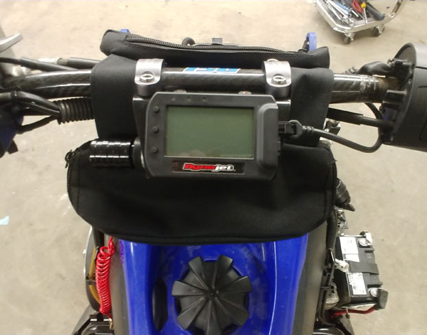

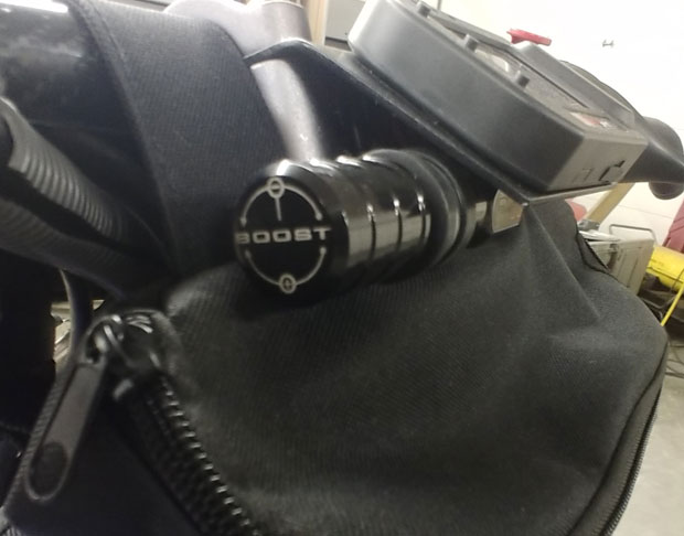

I was going to cut the plastic over the tank to mount the Hallman Pro (ceramic ball) MBC. My buddy had a better idea. We installed it under the POD. Also pictured is a cheap Powermadd handlebar bag I picked up a while back. I am waiting on vacuum lines that I ordered before I can finish the connections.

I already have that other clutch, that has been machined to fit, I just didnt know what spring or spring position to use, or if the helix would work.
