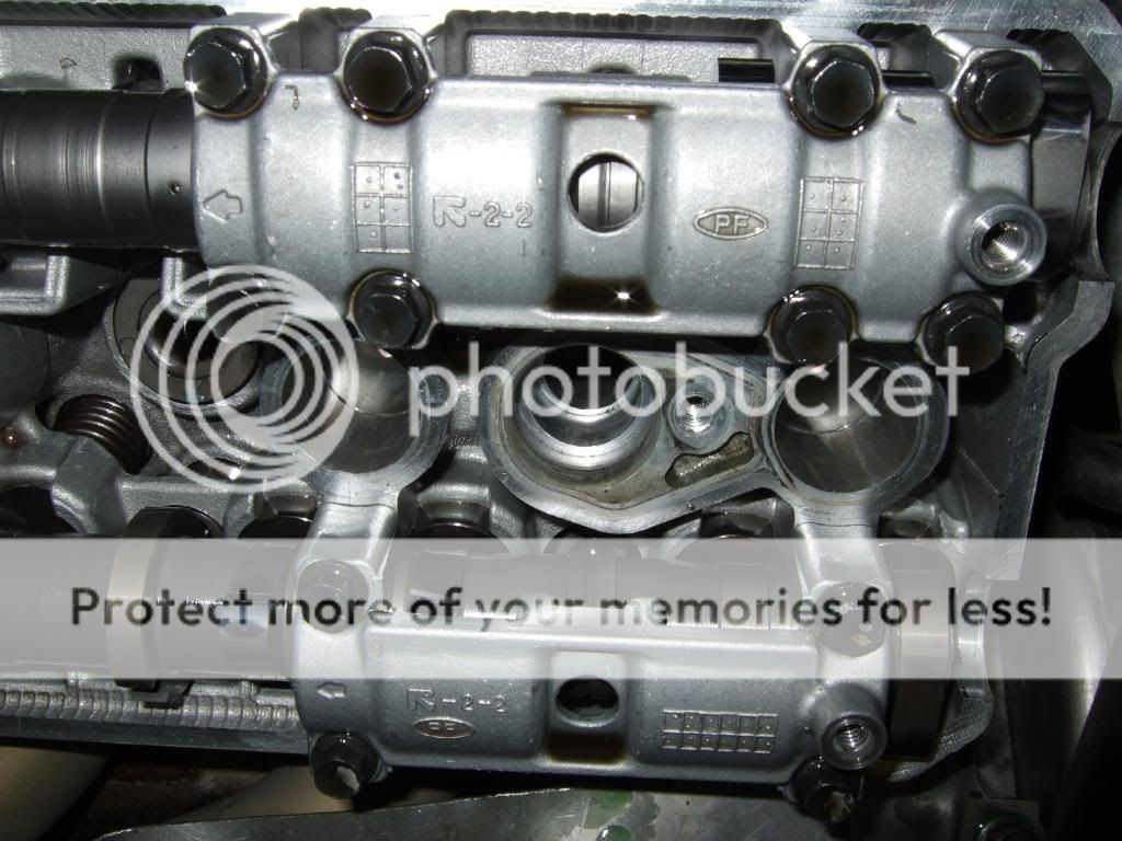

Does anyone have a picture of the cam timing dots after performing the recommended slotting of the cam gear on an Apex MCXpress equipped sled? I need a picture to help explain to a customer of both cam timing marks if possible! Thanks!
I don,t have a picture for you but the intake will be about a half a dot towards the throttle bodies and the exhaust dot will be about a half a dot towards the exhaust pipes
These pics are from a 06 Attak running MCXpress cam timing and 2 stock head gaskets stacked.
What Hurricane says, the pics shows the same, intake dot is about on the arrow pointer or a little towards the intake, exhaust has moved towards the exhaust slightly off the arrow pointer.
If I remember the MCX install guide correctly they tells you to grind the intake sprocket to move (retard) the intake cam back to stock position, the exhaust cam is advanced (which is better and makes more power).
