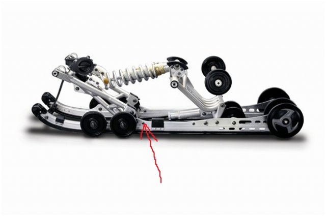

It's got just over 5 thousand miles. Ya I've seen those talked about tons on here as I've been searching Around. So that's where in that picture I'd mount it to help with cooling.This all depends on your milage.. What is it? We can help you better this way. Take it as the mileage comes to save money and time. Ice scratchers are a must on these machines unless you have powder trails all the time and no hard pack or ice type. They'll save your Hyfax and cooling. A cooler should be added to prevent overheating but for now if you have scratchers you'r ok .But if you want the best all around cooling system/ice melter get one. Their easy to put in.
I mounted a set of cable scratchers up behind the real wheel in an existing bolt hole just had to drill out a bit for take the 3/8 cable mount bolt and get a longer Gr 8 bolt to make it into the cable mount were the arrow is. I didn't do the bushings until thousands of miles into the machine. A Yama heater is great but there are ways around it if money is tight. Gauntlets,wind breaks,mittens.
