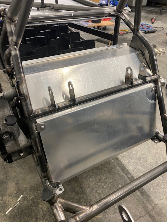

Couple years ago I made a heat shield for the header that was just larger than the header. My plan at the time was to do carbon fiber for the rest.
Fast forward to now and I recut a larger piece. Fuel tank will cover the top of the tubes so snow can’t get trapped in between. The sheet is .040 7075 and weighs 1.12 lbs. I don’t want to put any holes in the tubes on this frame so I’ll weld tabs on and rivet it.

Getting the bends figured out. The main block off piece will be .040 7075 with a piece of HDPE riveted to the back to keep snow from building up. The upper piece the header pipes go through will be .040 2024 since I can put tight bends in that. The 7075 needs a big radius to prevent cracking.
Getting general idea of clearance and layout.
It’s tight to the starter and filter but on this build I wanted the motor moved back.

Had to take the motor in and out a couple times to verify starter clearance with some practice pieces.
Couple practice bends first and then got the final piece bent up. I need to notch out for the jackshaft bearing carrier and weld some tabs to the frame in a couple spots to rivet it to.
I wanted to stick with as much tubing as possible and thin sheet metal to keep it light but it definitely would have been far easier to just make a .063 or .080 tunnel and build around that. I’ve got my work cut out for me to enclose around the chaincase and some other areas. Probably just end up using HDPE for it since it’s easy to work with and flexible.
