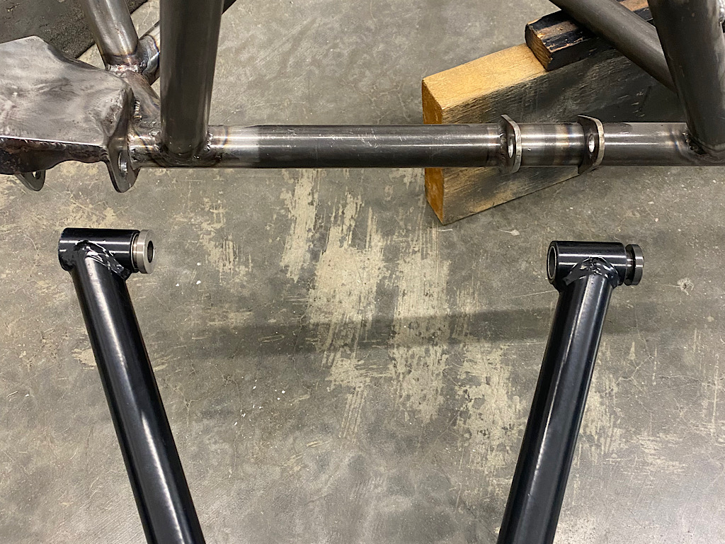

Can someone familiar with this chassis tell me which way the sleeves are suppose to face?
1.
Or 2.
1.
Or 2.
- 5,498
- 4,166
Both pics wrong. The front flange faces forward and the rear flange faces rearward.
Nikolai
That’s what the microfiche showed when I looked a few days ago but then I have to squeeze the a-arm together to install it. I don’t understand where I am off because I used factory bushings to make correct width spacers for the jig. Maybe it’s normal to have to squeeze the a-arm?Both pics wrong. The front flange faces forward and the rear flange faces rearward.
My thought was to get a second set of bushings, essentially cut them in half and machine 1/2 the shoulder off each one in my lathe so I can get a shoulder on each side if that makes sense, it would take any pressure off the a-arm.
I have been making progress, just not ready to post yet. Ordered a bunch of hardware and some other stuff so I could finish up the front end 100% the way I want before installing the motor.
- 5,498
- 4,166
I don't know, but I'm thinking it should fit without forcing.
