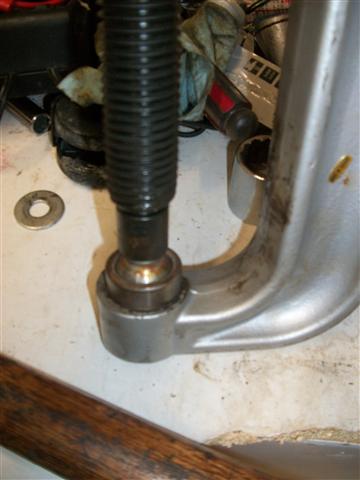

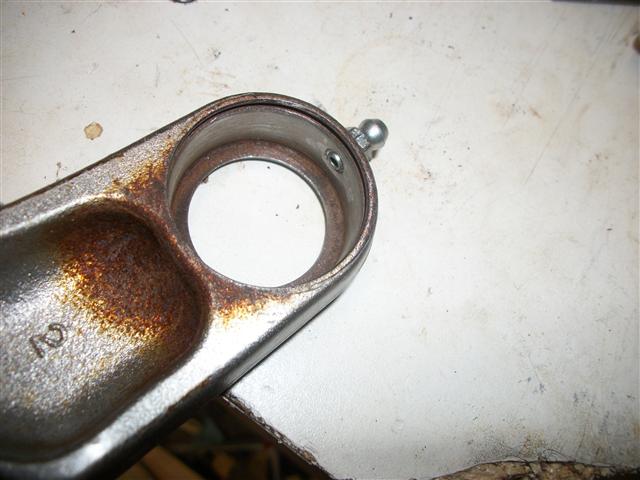

I just did mine and it went really easy and didn't need any shims. I made some modifications to the procedures and the races themselves to add a zerk fitting to further extend the service life of these excellent races. With only 1800Km on the originals, one was pretty worn and the other not too far behind.
Maybe the only thing I would have done differently would be to drill and tap the hole in the A-arm with the new races installed without the ball. One of the zerks I installed is a bit loose because it can't extend enough into the race and have enough threads to properly grip in the A-arm. This would allow the zerk to really extend into the races, prevent rotation and flow grease.

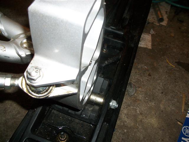

Very neat work on the grease nipples. One question (as always playing Devil's advocate), Would they be exposed to possible impact from sticks, stumps, etc. being right at the tip of the A-arm like that, or are would they be tucked inside the spindle?

BombaPolaYama said:Very neat work on the grease nipples. One question (as always playing Devil's advocate), Would they be exposed to possible impact from sticks, stumps, etc. being right at the tip of the A-arm like that, or are would they be tucked inside the spindle?
That's the first thing I thought of when I saw that. I think there was a guy that put his on the inside/bottom of the a-arm. That does look more prone to breaking off.

Nice. Didn't think it would sit in that far. Easy access, too!
BombaPolaYama
Jeffz said:Nice. Didn't think it would sit in that far. Easy access, too!
Yeah, a pic is worth a thousand words. Looks well protected.
