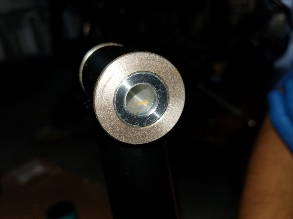

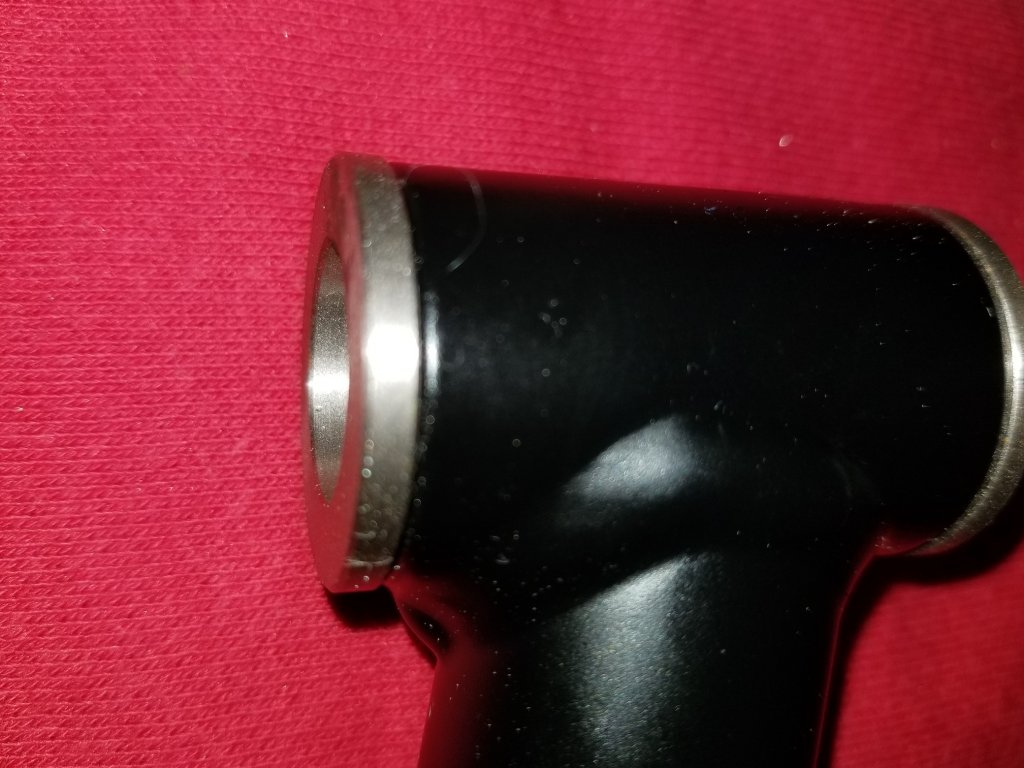

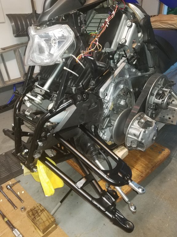

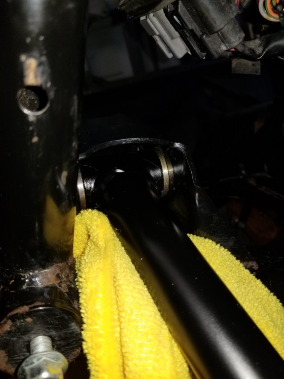

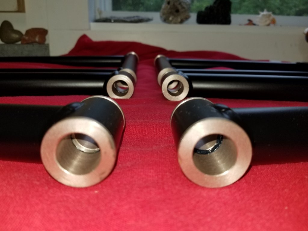

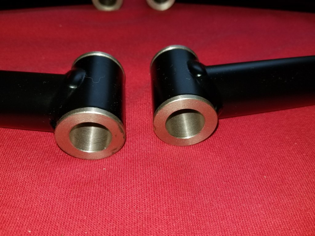

I called them prior to installation and confirmed greasing them up was fine, as shown in the pics, greased up, lined up on the bottom, turned a-arm over and tapped a wood block with a hammer to seat the other side... worked well. Not sure what you mean with squeezed out the oil as I thought it was a copper metal matrix vs. actual "oil" impregnated...I pressed mine in with rubber jaws on my vice. Not good. This sealed the ends and squeezed oil out of the oil lites. Need to leave a space as to not seal them tight. Spindle bushings from the Bushman are a huge improvement also.
Dr. FeeLGooD
The metal is infused with oil. Lots of it.
