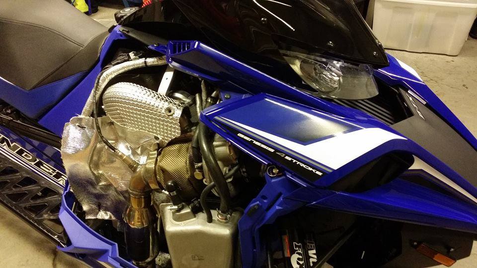

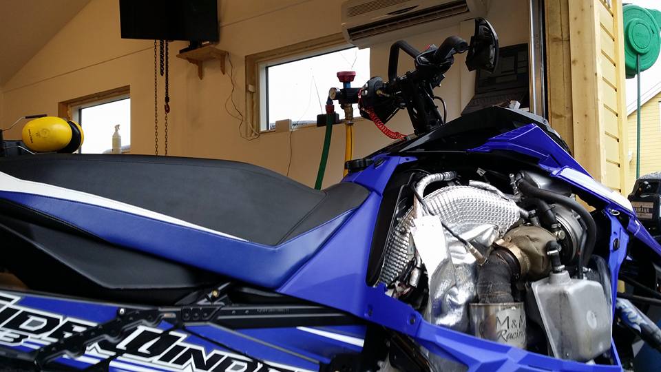

This i tought about for 2 years ago when i bought the sled. I changed to a Apex oil tank and it works great
Problem solved

Nice!!This i tought about for 2 years ago when i bought the sled. I changed to a Apex oil tank and it works greatProblem solved
View attachment 142327 View attachment 142328
