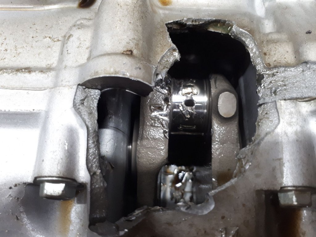

Sorry to hear that, but fear not..I bought 2 brand new 2003 rx1's...and clipped a log with one, and broke the sump and the engine when it ran out of oil...My dealer rebuilt it for me...just matching bearings and cranks and stuff...first one he ever did..maybe the last..lol....but it ran like a bear. still out there running somewhere...UPDATE: New motor time, they are replacing the entire motor, turbo, etc. I'm not sure how I feel about it. They say it looks like a casting issue internally letting the coolant get into the oil. Also you can not get assembled long blocks from yamaha (Thats what they told me anyway) so they are order every part, gasket, etc separately and will assemble at the dealer. They feel confident they can do this well and it will be better then a mass produced engine.
Such is my luck, first brand new sled ever and it comes with a bad motor and record snowI don't even know why I like this sport some days!!! I have located a BRAND NEW 06 apex I may buy!

That really sucks kinger. I believe the 998 is built in China! Remember the Viper rod fiasco? I think Japan is sourcing to China since the tsunami happened and its rearing its ugly head as of late. Things that make you go hmmmm.

I'm a little surprised that this engine can't be sold as a long block. When I was working at a dealer we had a new 2004 RX-1 that seized up with only 24 kms on it. Yamaha motor out of Toronto promptly brought a complete new engine down. One of the service reps delivered it himself as they wanted to see what was wrong with the original.(oil pump drive shaft snapped)
As far as the outsourcing of engine building, I believe it was Sabaru, but I'm not sure where they were located. I wonder if they also made rods for the 16 Apex, because just last week I saw an Apex engine with a con rod through the side of the block, and yes it was stock. 5000kms, first one I ever saw blow.

Kinger, apparently internal leaking happens to other brands too. I just got off the phone with my neighbour who has an 18 850 Doo, and asked if he wanted to ride tomorrow. He says "I'd love to, but my sled is at the dealer getting a new monoblock because it had a crack and coolant was getting into the engine."

Well sled still is apart at dealer. I have had some members PM me with valuable information and we think the head was the culprit. I’ll post more once I confirm. In the meantime. It’s going back together with some ARP head studs so she is ready for more boost next year. Apex will be built as a backup! I also bought the YES for 4 years on it which makes me sick but it is what it is. Yamaha if your reading your fading fast in the minds and hearts of even the most extreme loyalists like me. Get in or get out of sled business please.
