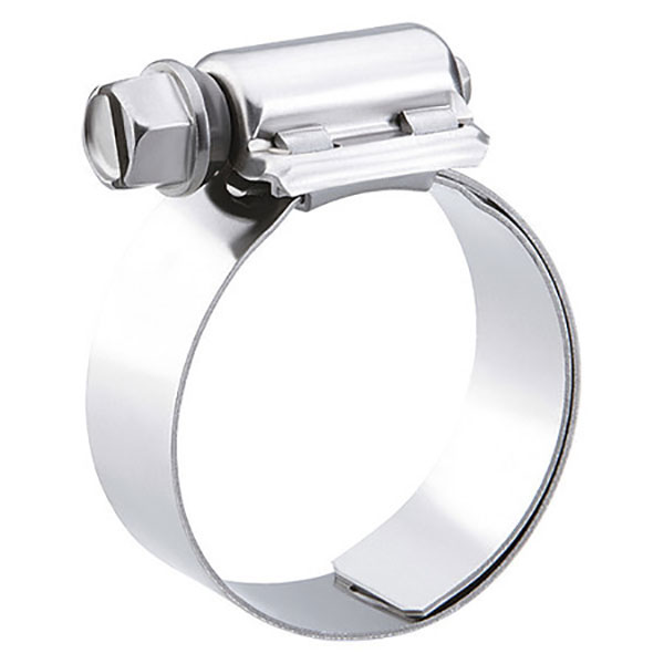

One common thing I've seen that causes leaks on many sleds is the factory clamps aren't sized right. Some are too big for the size hose they go on. If you look at the far right pic, you'll see it. When I do engine work, I put much better clamps (aircraft liner clamps) that are sized correctly so when they're tightened they end up round and don't have a flat spot under the worm drive area. That's what happens when they use a clamp that's too big. The flat spots aren't round so they can leak even if the clamp is tight. Another ugly piece of Cat DNA.

Just FYI - posting link to liner clamps. Notice the liner prevents the hose from touching the threads of the clamp. Much smoother clamping action and if sized right, stay very round as they are tightened.One common thing I've seen that causes leaks on many sleds is the factory clamps aren't sized right. Some are too big for the size hose they go on. If you look at the far right pic, you'll see it. When I do engine work, I put much better clamps (aircraft liner clamps) that are sized correctly so when they're tightened they end up round and don't have a flat spot under the worm drive area. That's what happens when they use a clamp that's too big. The flat spots aren't round so they can leak even if the clamp is tight. Another ugly piece of Cat DNA.

Very nice. I will have to get some of them. The clamps I used did chew up the outer jacket of the hose.Just FYI - posting link to liner clamps. Notice the liner prevents the hose from touching the threads of the clamp. Much smoother clamping action and if sized right, stay very round as they are tightened.

What size are needed 7/16?Just FYI - posting link to liner clamps. Notice the liner prevents the hose from touching the threads of the clamp. Much smoother clamping action and if sized right, stay very round as they are tightened.

I bought a whole range of these clamps to replace most of the junk used at the factory. Each one has a useable range. Just measure the OD of the hose you want to clamp and order a size that will clamp a little smaller than that and you should be covered.
