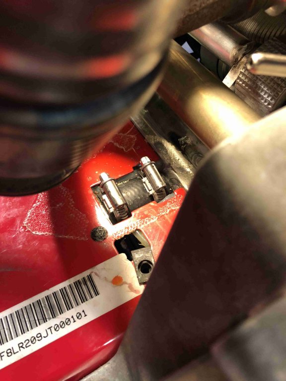

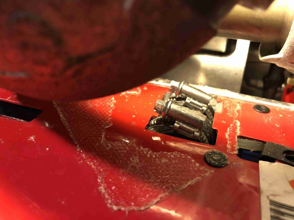

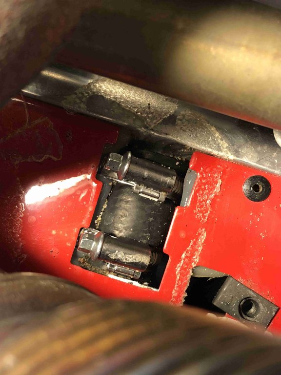

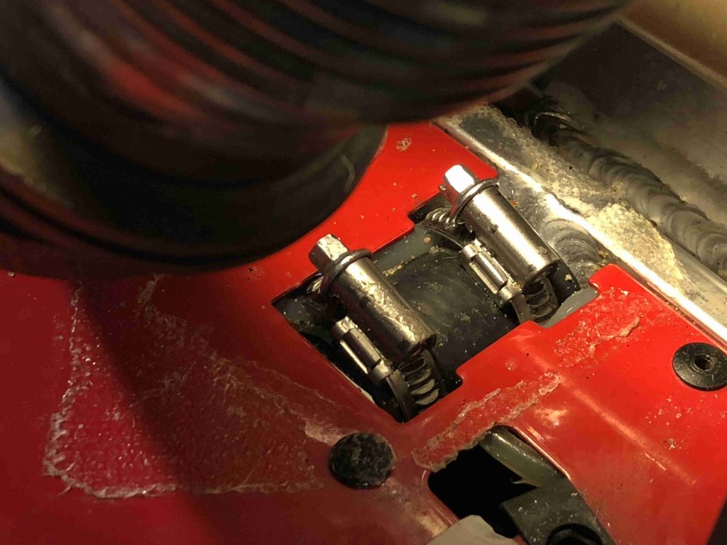

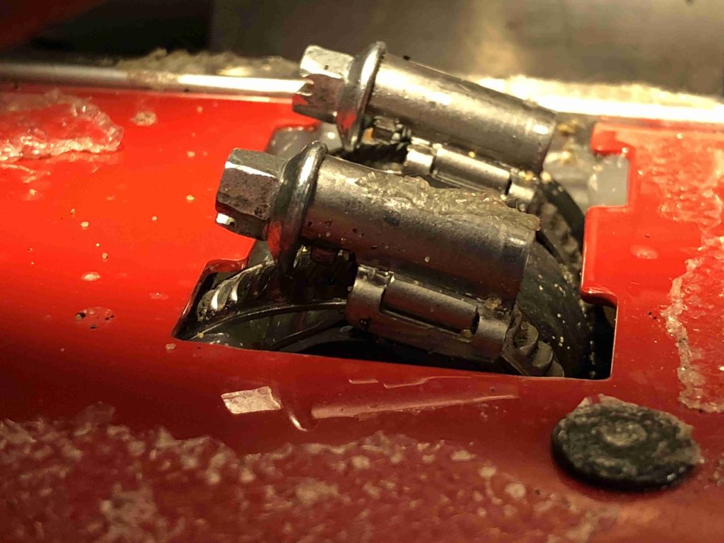

Got a small coolant leak. Noticed today when pulling sled off trailer. SURE enough right where Dan posted pics. Just over 3 k on sled. Noticed coolant dropped after COLD conditions last trip. First I saw a drop in coolant. Guys have coolant drops especially after COLD conditions they need to check clamps in the post here. Great find Dan and good post. I store my sled in heated garage and saw zero coolant leaks. But when sitting out or in trailer in COLD conditions it appears.

Even if you dont see coolant on floor, always reach up and grab right side of drive axle(between right driver/sprocket and tunnel.) But closer to driver. That is where I always had the coolant dripping down. So I tend to reach up there alot and see if I can feel coolant, as coolant is quite slick feeling.
Sucks that its so hard to get at.

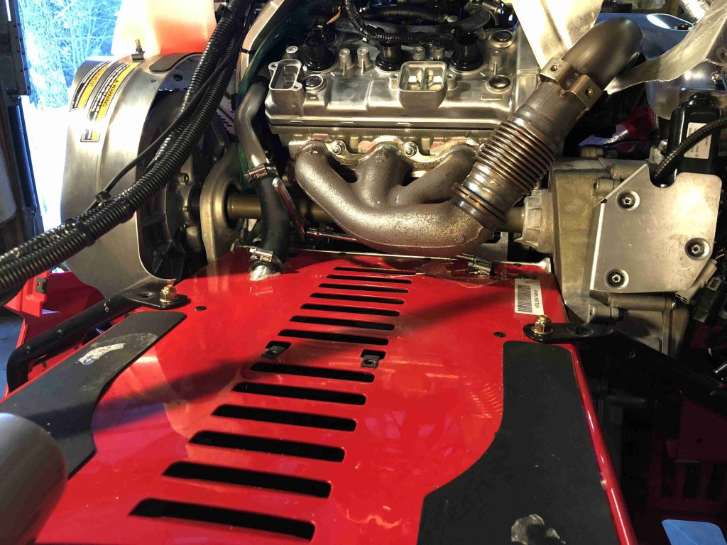

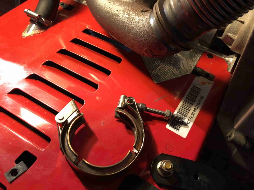

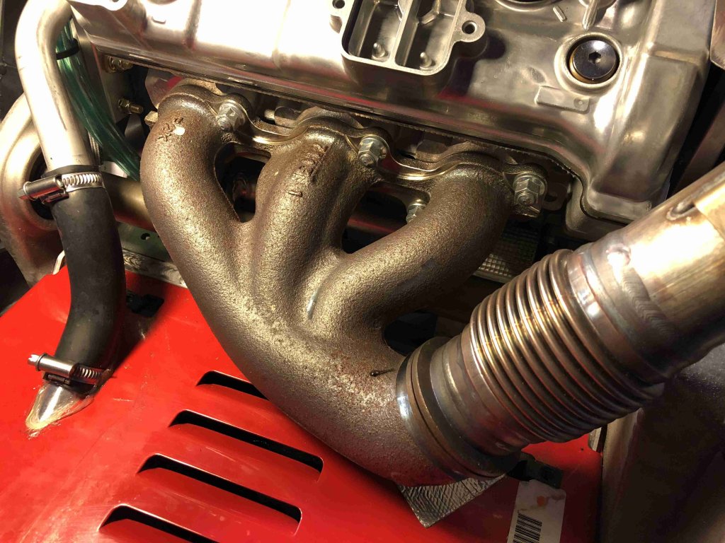

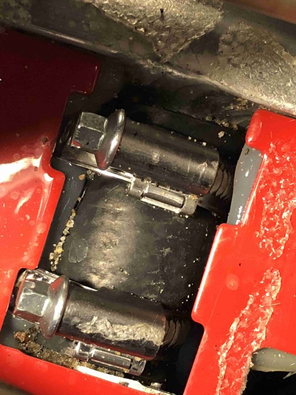

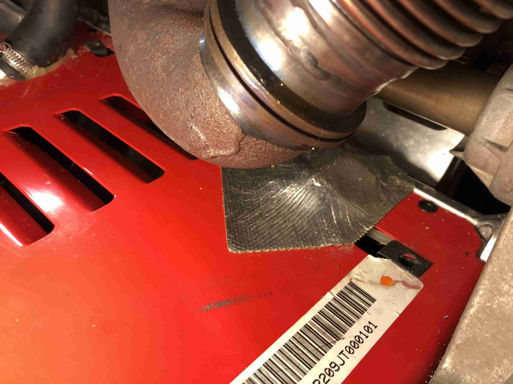

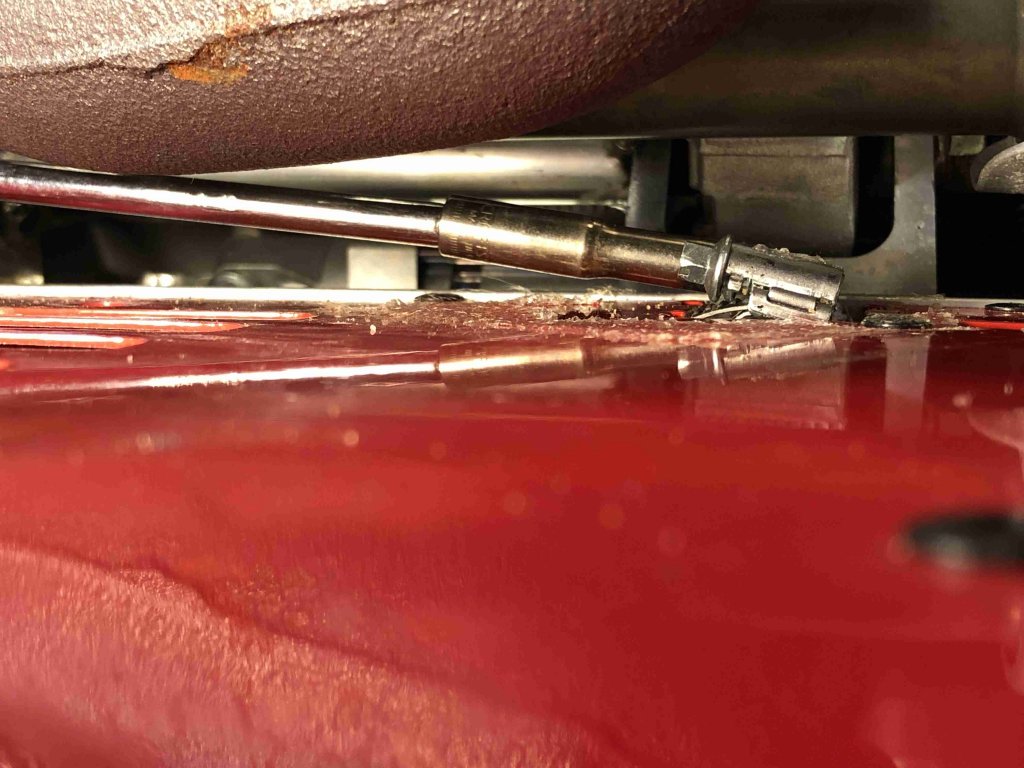

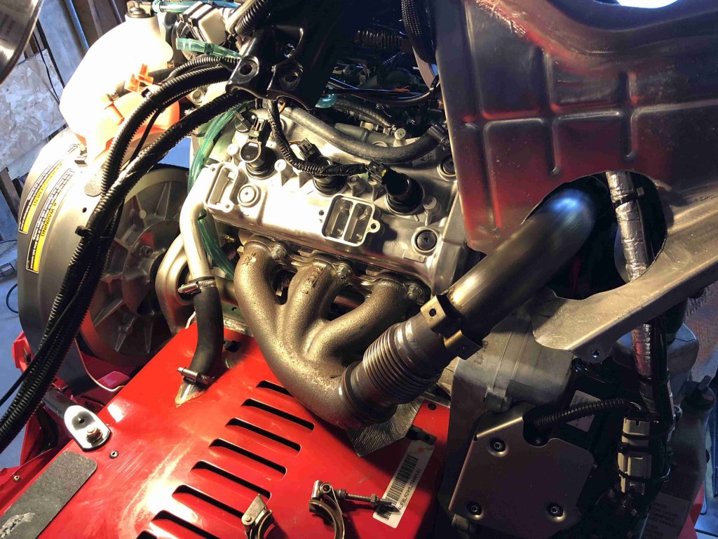

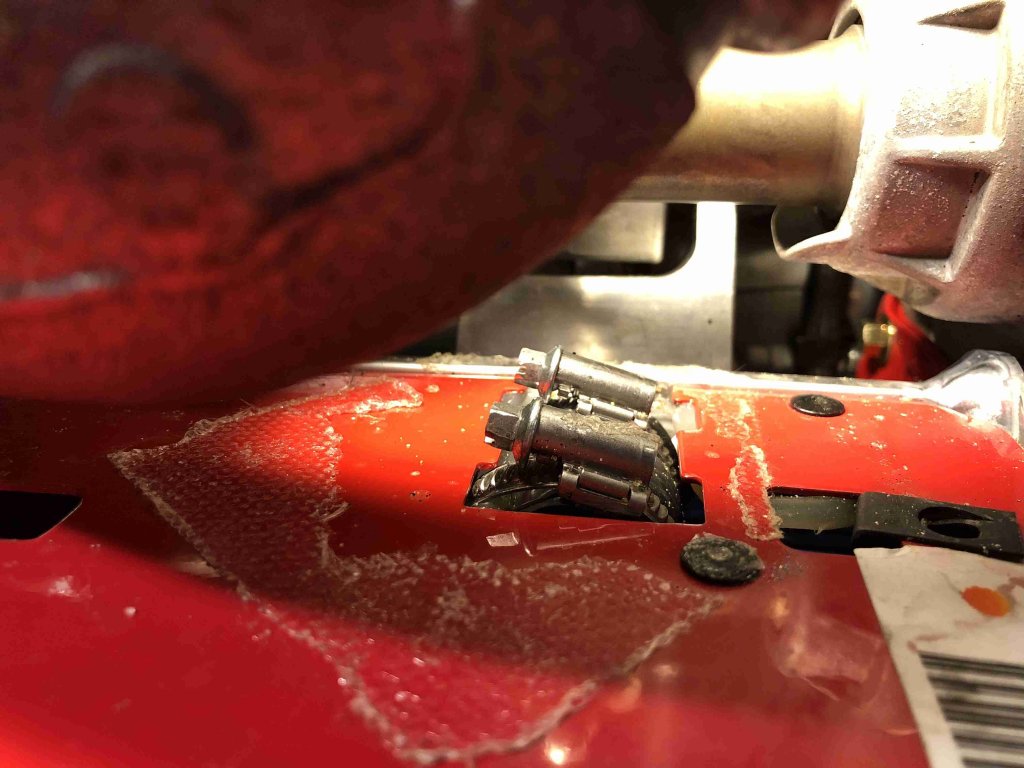

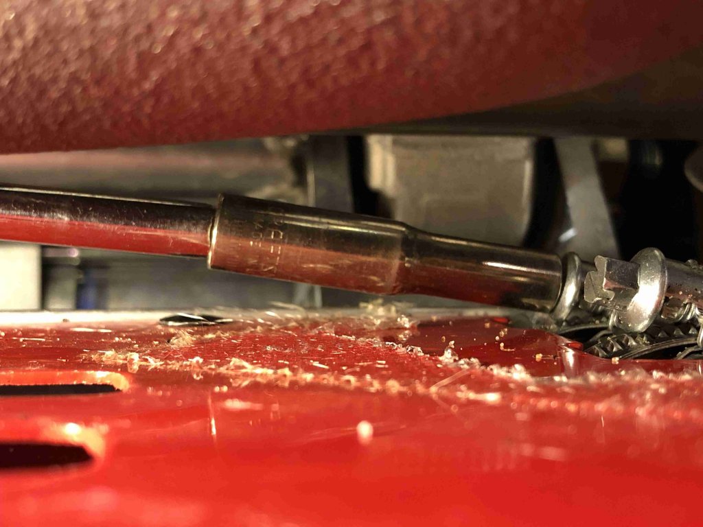

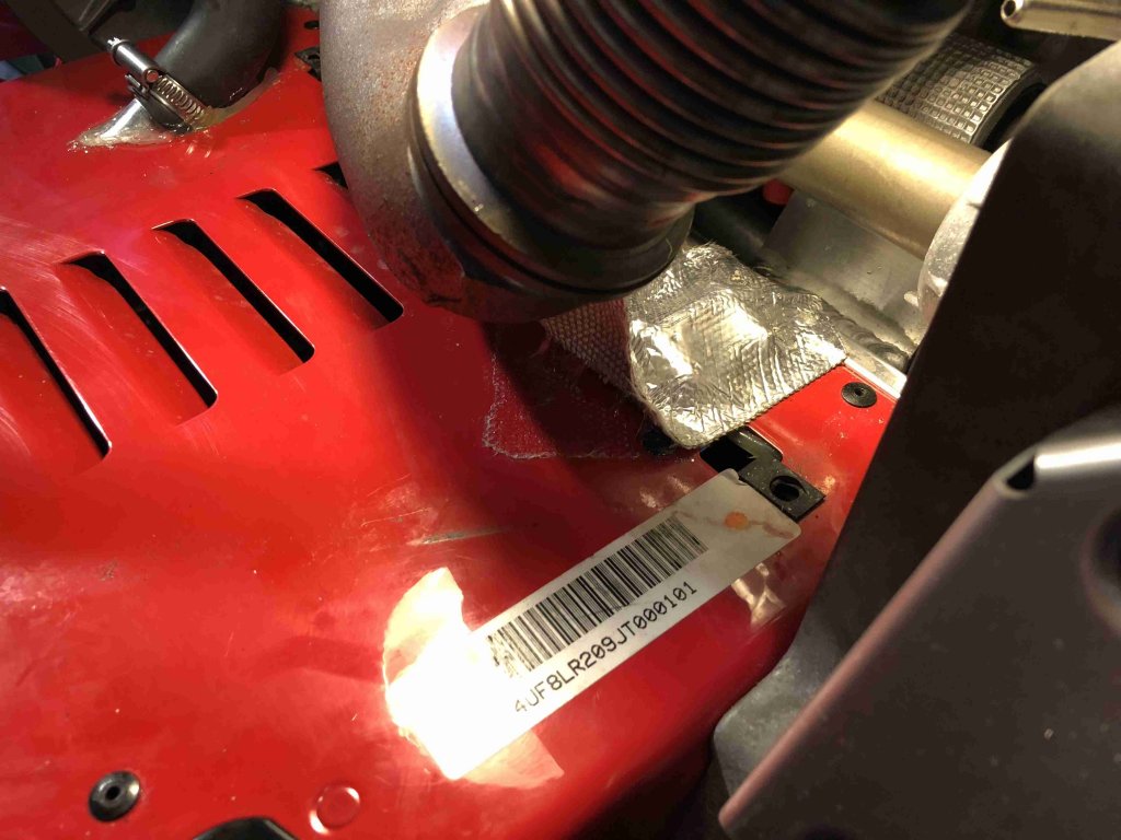

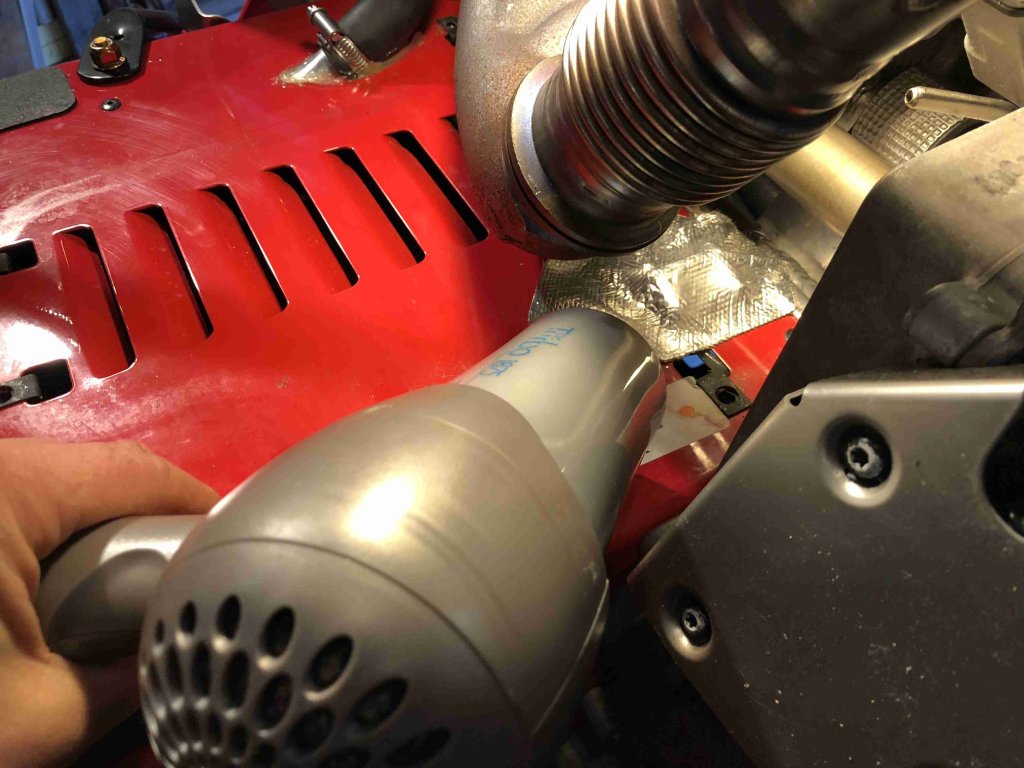

All I can say is O my God! You have got to be Kidding me!Now down to the header shroud....must remove the V-Clamp from header to pipe. This will allow you to slide upward the header shroud and out of the way, so you can get at the clamps.
There is heat foil over top of this hose, which is important as the header glows. I used a hair blower to heat up the glue on it and removed it. It loses its stickem abit, so when reinstalling I clamped it in with the bolt for shroud.
Dan
View attachment 134963 View attachment 134964 View attachment 134965 View attachment 134966 View attachment 134967 View attachment 134968 View attachment 134969 View attachment 134970 View attachment 134971 View attachment 134972 View attachment 134973 View attachment 134974 View attachment 134975 View attachment 134976 View attachment 134977 View attachment 134978 View attachment 134979 View attachment 134980 View attachment 134981
