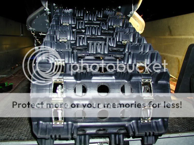

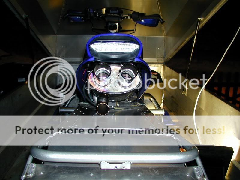

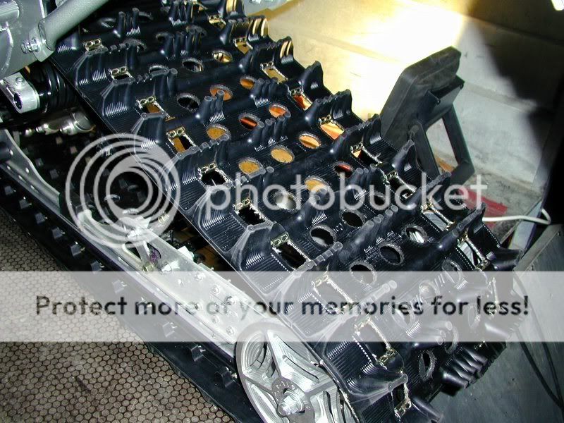

teerex said:
With these modifications this FX turbo should be fun.... just have to wait some days to test it. All snow rained away this weekend :o|
Drilling track and letting the exhaust come out the easy way:
nice ride ;)!

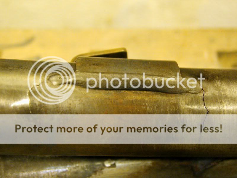

Did some repairs in may, here are the pics. Cracked exhaust caused by loose exhaust clamp. No I did not install the turbo kit myself :o|

^ Did you install new clamps or did you weld in the mcx flex joints?
And where the exhaust cracked by the hanger was it caused by the bolt
being loose?
No I did not install new clamps. I guess it will not loosen again when tightened to the specified torque.
Someone must have forgotten that last year :o|
No the bolt at the hanger was not loose. But maybe the pipe cracked because of stress or poor construction.
Ok you re used your clamps, When I had mine tore apart last year one of the clamps was loose also, I guess its a good Idea to check them once in a while. Thanks for posting the pic.
