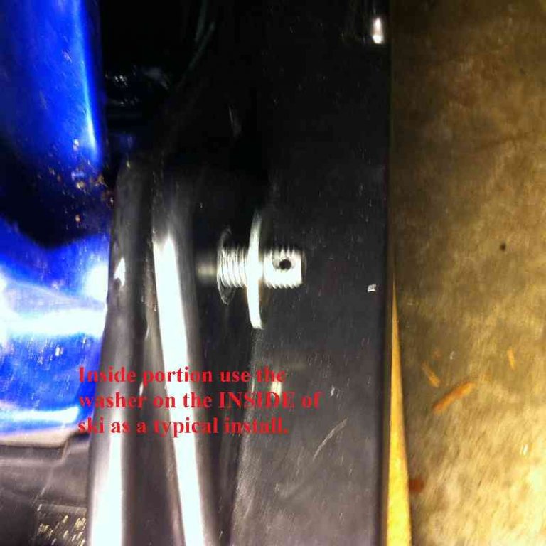

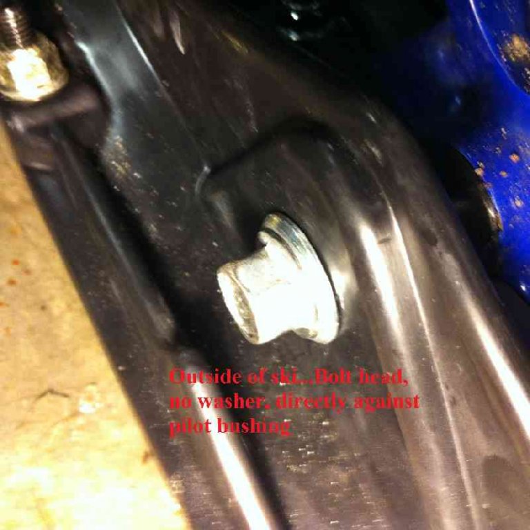

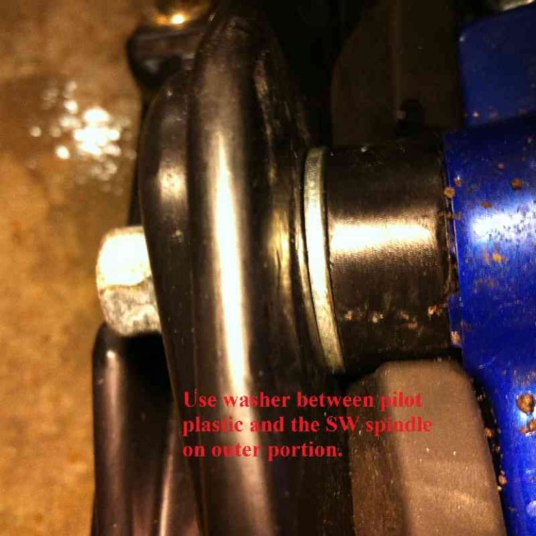

SW main ski Bolt and washers:
Now that we have the OUTER bushing reinserted, we can change the washer setup on the ski bolt install....
We need to do this cause the spacing after the bushing change, still is not exact and additionally, now that we have changed the outer bushing, we want a shoulder INSIDE that outer ski plastic, between the SW spindle and the plastic ski(since the bushing shoulder is now outside) so it does not wear on the plastic.
From outside to inside: Bolt, Bushing, Ski, Washer, SW spindle, Bushing, Ski, Washer, Nut, cotter pin.
Dan
View attachment 125290View attachment 125289View attachment 125280 View attachment 125281 View attachment 125282 View attachment 125283
