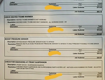

It clearly says they plugged the line and called the solenoid "a boost sensor"..lol
View attachment 161374 Here is the work order done by the one dealer!!
It clearly says they plugged the line..lol
Its almost worth a call to their service department...but they may not be receptive to anyone's input or advice.
