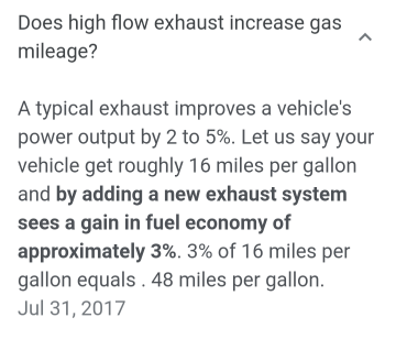

I've polled the internet a few times. Seemingly the answer is the same. Most whom have added a pm to their tune, has provided a decrease in fuel consumption.Less throttle position only because throttle position is mapped to a higher range of potential horsepower. Consumption of fuel/air is the same, and the only way to reduce consumption is to run closer to ideal AFR (from rich) or to change gearing.
Your comment would have me believe that opening the exhaust would have zero effect on efficiency. Or how about we agree that the pm tunes are closer to 14.7 ratio (during cruising) then non muffler tune?!?! Idk...idk lol.
There is an 80/20 rule that applies to most things in this world. And I would say from my gatherings, 80% claim getter Better mpg.
I'm positive Ben at Turbo dynamics has made the same claim. But I take his input with some salt, due to his position. Total respect.
My point is that throttle position is less evidence of fuel consumption and more related to how much juice you have on tap. It makes sense that the more HP on tap, the less throttle input required. Fuel consumption is dictated by volumetric processing over time, the more air you process, the more fuel you consume. Do I believe that these tunes give you better than stock fuel mileage... sure, because by design and intent they are processing more efficiently (timing/mapping). A more effective way to get better fuel consumption is either through closed loop operation where the ECM can manage AFR in real-time and/or better gear selection.
Well said..
there’s so many variables to fuel mileage but I don’t understand why guys say that they ride fast and now with a tune get way better mileage than stock.. what is fast to them ??
With just my experience I know it to be true but if I decided to search the web I cannot find any articles where opening the exhaust decreases motor efficiency
Share with me one article explaining the polar opposite.
