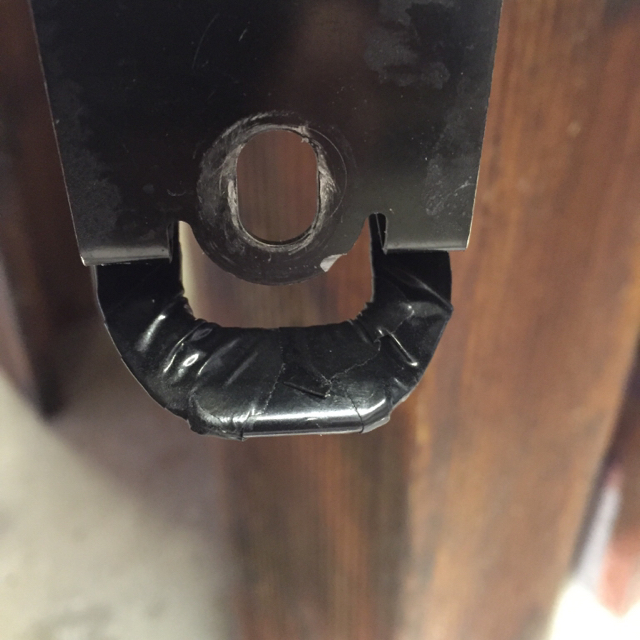

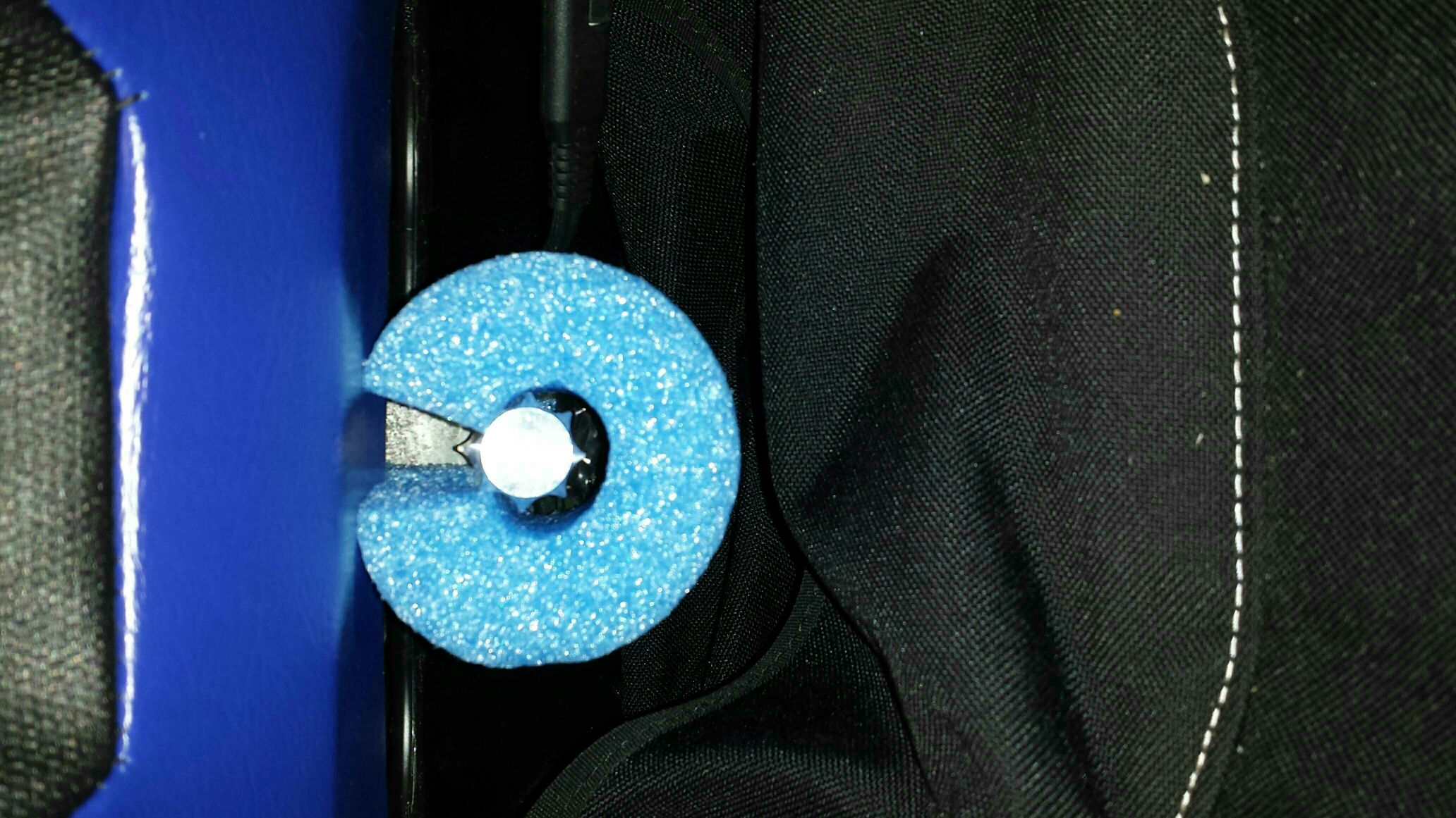

Those with a tunnel bag may have noticed that the seat clip/bolt or thumb screw wear through the bag. So here is my answer and all it cost me was my buddies kids yelling at me.
Now slide it on.
If it lasts the season awesome no ripped tunnel bag
Where there is snow. I hope

That's brilliant. I rounded off the edges with a grinder and put some tape around it but will look to do something similar

Smart!!!
I just cut it off and no issues but yours is nicer

Very nice, I ground mine down then deburred/radiused it with a Scotch-Brite disc but unfortunately I didn't do it until after I had a big hole worn in my bag from the sharp edges of the latch.

Cat one had the reinforce patch a year ago, same bag with different logos I assume, maybe you got old stock or something........still rubs through the patch though

put a little tape around mine today also...... what the hell, no snow anyway.

I rounded the corners with a grinder and glued on a piece of windshield trim. No more wearing on tunnel bag

Same here with a chunk of door edge molding, but I haven't installed the bag yet.
