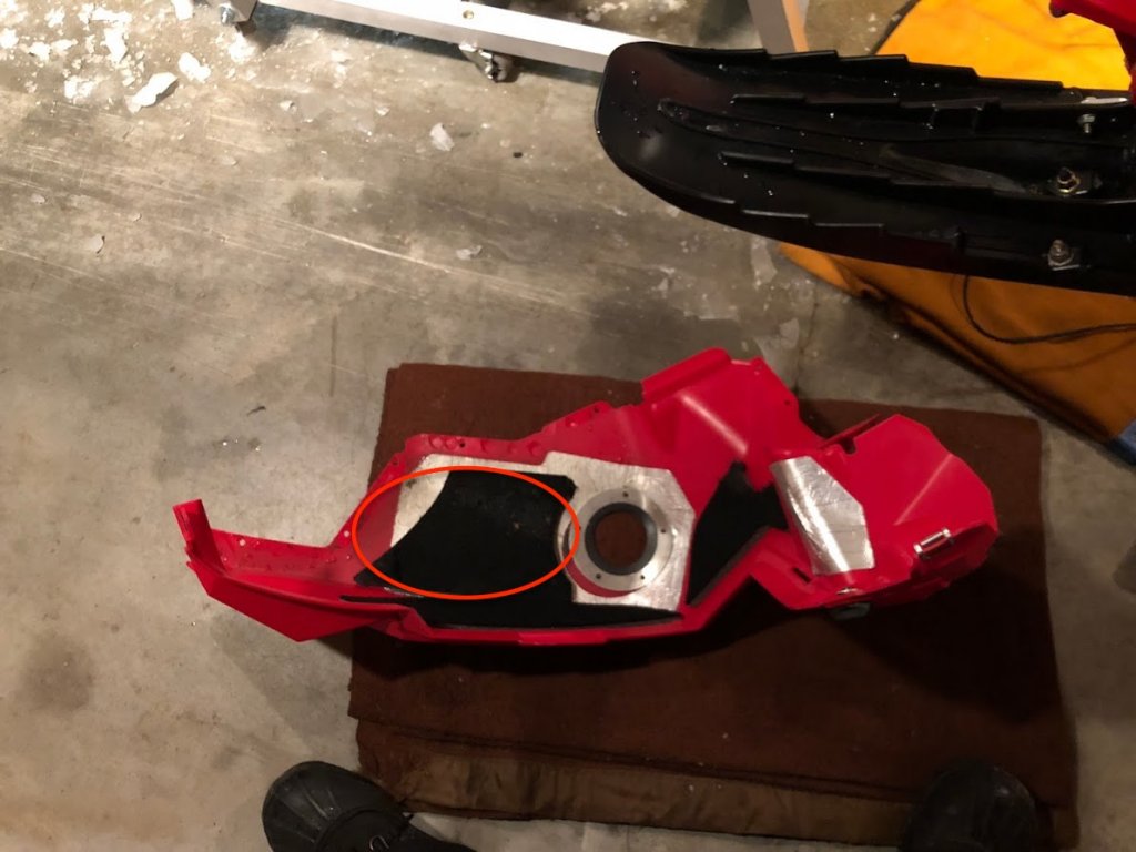

For guys asking about foam. It's the black stuff stuck to the lower right belly pan. It can and will soak up oil if you are not careful when draining your oil and therefore can become fire hazard.
If removing, be very careful to assure there is plenty of REFLECTIVE FOIL TAPE below on pan, clean it good with alcohol so it sticks good. As seen below in pic, the bottom of muffler has ZERO heat shield so it will allow maximum heat to radiate downard from bottom of muffler.
Dan
View attachment 150946 View attachment 150947
Yes good point Dan

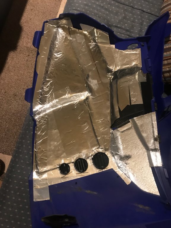

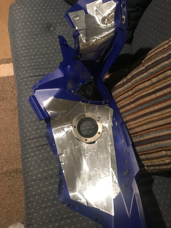

I always have the cheap stuff from Depot(foil tape for insulation) around and use it liberally on many sleds in the past, it certainly does a great job to reflect heat. If I go with a SM tune next time round, Ill remove those foams around muffler, looks to be one up the side too. Just gotta be sure the guys realize raw plastic withOUT any heat tape wont last long..lol
Dan

Mine looks like a gay bath house.
Not that i'd know what one would look like.
Not that i care if you do. Just sayin'

There ya go! Nice work 'reflecting'...lolMine looks like a gay bath house.
Not that i care if you do. Just sayin'View attachment 150956View attachment 150957
