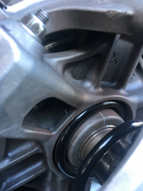

Yes. All it would show is what happened first. Roller or crack. A roller doesn’t go out instantly so if no mark like the cat one it would mean the crack happened first.Bottom of the spider? Where? Under the roller?
Like the pic you posted before? I will try to get a pic
I see your point. The rollers in Tommy's clutch are still good, but will have the clutch today or tomorrow.
The clutch will be totally dismantled and will get pics of the cracks with dye penetrant, spider and wear on rollers for a clutch with 1,486 miles.

called a few different dealers all told me that clutches were not covered under warranty. A friend of mine who is not on the site referred me to hauck powersports in rice lake wi. I called them up yesterday and they claimed that they have warranty quite a few clutches like mine already in which Yamaha has not questioned any of them yet. So will see what they come back with hopefully done in a timely manner.

Catch of the day. ...
I have manage to came back home slowly whit the left foot far away from the clutch!
I have change a lotssss of parts along the way( +/-16 oookm) Time to go back to old primary
View attachment 153384 View attachment 153385
That was a good catch. You got lucky to spot that one!!!!
My buddy and I have both cured the roller issues along with the binding issues we both had by going back to the old clutches.

The sled was staying highly engaged, this could have been dangerous!That was a good catch. You got lucky to spot that one!!!!

Had that happen on my nytro clutch.Catch of the day. ...
The crack kept coming out and the entire roller arm snapped off, came through foot hold.
On your Sidewinder?

No, on a nytro I used to own.On your Sidewinder?
