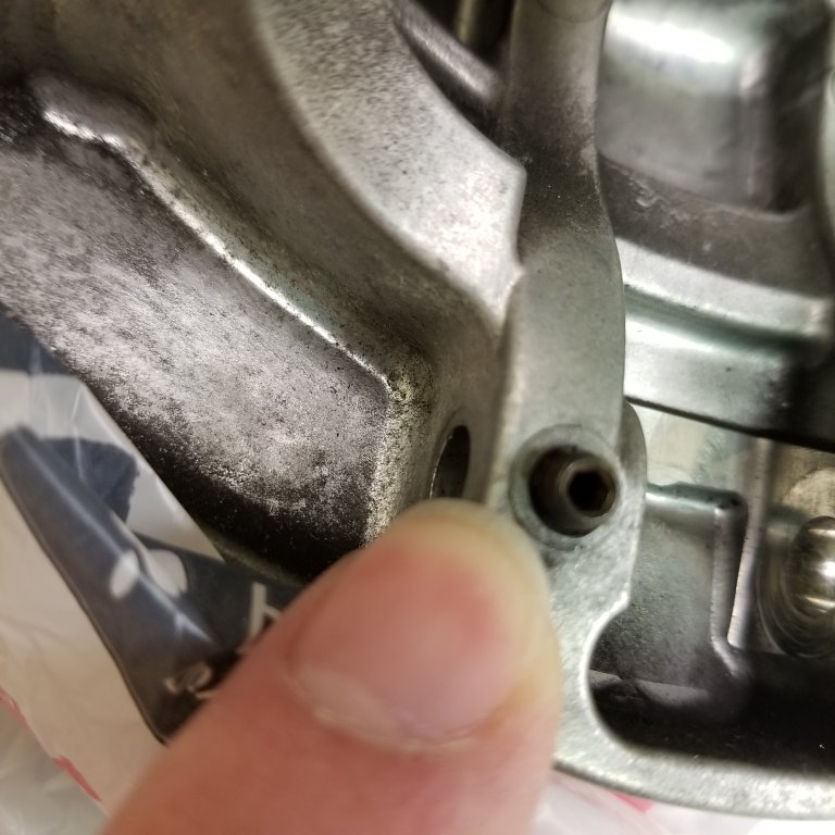

Are those Penetrant Test photos of the OPs clutch after this episode? Or just some random clutch that you discovered weakened?
Different clutch all together
This was noticed on a customers sled in for clutching service and clutch kit. Noticed the cracks where the weight pin goes thru and by the set screw. This was caught before coming apart....and still have the sheave here.
The penetrant test was done to verify the cracks were what we saw and to prove where the clutch starts to weaken.

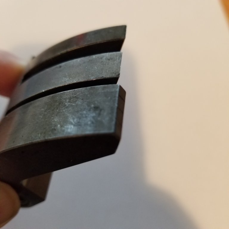

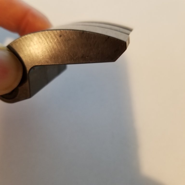

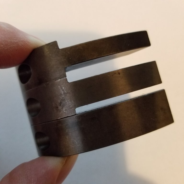

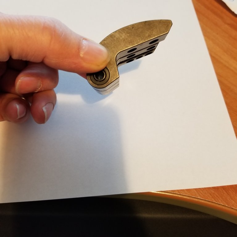

We, at Thunder Products Clutching are gathering info from all over Europe and North America and continuing to monitor the status of these clutching issues. We are watching all of social media and forums, plus gathering information from our dealers on what is happening with this Sidewinder Primary clutch.
The 48 gram HH weights that we sell for the older 2 stroke sleds are the same length as the 58 gram weight and the 74 gram weight that I have included pictures. These weights haven't been changed in years and have plenty of weights here that we checked all of our inventory when this issue about weights being too short came about. All I can say is our HH weights are not shorter than the original Sidewinder weight and definitely longer than other weights.
There have been clutches coming apart with ALL weights....even stock. The clutch sheave pictured in my previous post with the cracks was from a stock clutched, stock flashed sled.
If there are any clutch cracking or coming apart problems....PLEASE bring this up to the attention of your dealer! This clutch is defintely not strong enough to handle the power of these turbo sleds.....even stock
