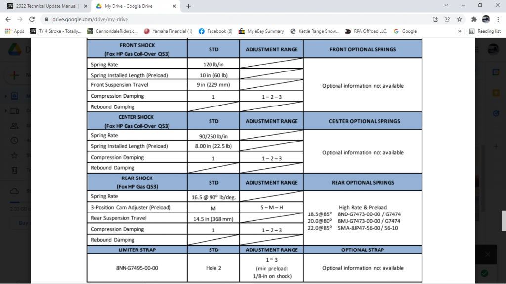

Here the actual listing in the tech book for u, so u probably want the 22 lb ones
Thanks this is exactly the info I was looking for. The springs don’t weigh any where near 20lbs so spring rate makes sense now.

Here is from 2022 Technical Manual For Sidewinder LTX SE
