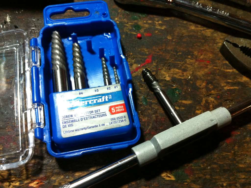

The stock bolt that was removed/installed several times snapped on this one...grrr
spent the day monday drilling out the hardened bolt, and finally got an easy out on it and it came....pain in #*$&@!
I now chase threads each time before new install, and use hi temp anti-seize and will be trying SS bolts this next time, and do not torque them too tight, and use a lockwasher. Also will only install NEW bolts each time, never using bolts more then once anymore. Also use 20mm not 25mm length.
Dan
