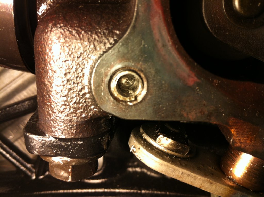

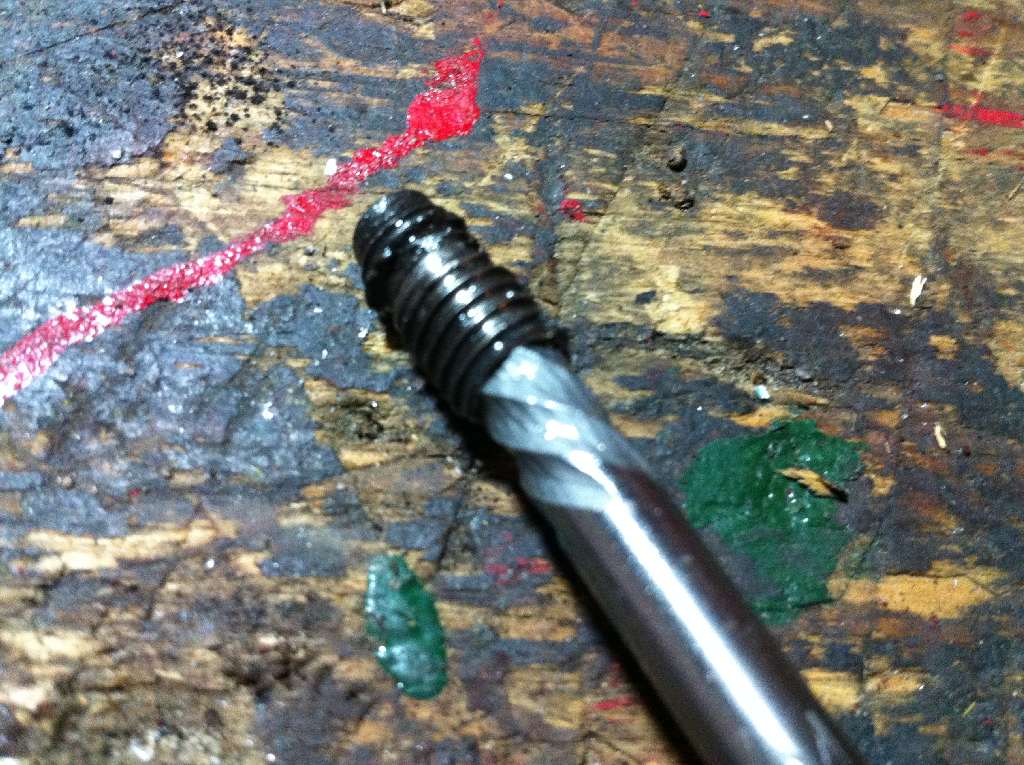

I agree with all you just said, I still have one broke off with a drill bit snapped off inside but there is no exhaust leak so I'm not going to worry about it till spring. I have the four corner bolts in with the super quiet so I'm sure it's all good.The stock bolt that was removed/installed several times snapped on this one...grrr
spent the day monday drilling out the hardened bolt, and finally got an easy out on it and it came....pain in #*$&@!
I now chase threads each time before new install, and use hi temp anti-seize and will be trying SS bolts this next time, and do not torque them too tight, and use a lockwasher. Also will only install NEW bolts each time, never using bolts more then once anymore. Also use 20mm not 25mm length.

Stock bolts are a hardened bolt(ask me how I know GRRR) and take quite some time to drill out. Same as these ARP Bolts, I did alot of research on them and heard some horror stories too.
Stainless does well with heat(see below) and is softer.(the A-286SS is nice but very pricey) It wont corrode but when trying to loosen it will tend to be more forgiving, where as a hardened bolt material will SNAP off the head as it has no give. Sorta like tempered glass treatment. But lets face it, ALL bolts will snap no matter what you use, once they GALL into the threads from the constant red hot heat and cool over and over.....SS is at least gonna be easier to drill out.
I have worked with SS alot, its super easy to drill out as it soft...one drill bit will do it. While I went thru about 6 bits drilling out stock bolt....and half a day..lol
