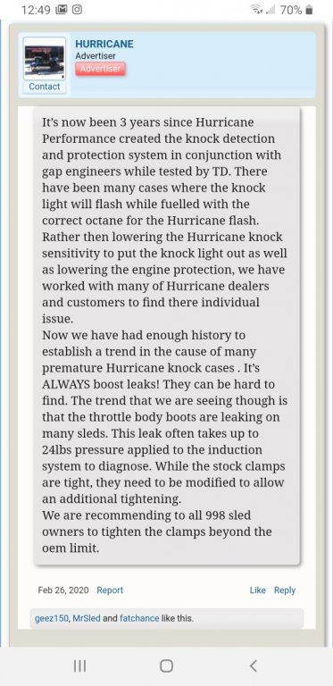

Don't know for sure. Maybe chat with Dave at Hurricane since he was the one who said they've seen it multiple times.
I think they can leak even when new. Especially for those of us who have more boost than stock. From what I saw, there really isn't that much compression on the boot with the stock spacers at .250" length. Maybe Yamamarc has thoughts?
Dave is the guy to talk to about this since he has all the data and trends collected on the issue and resolution mod for a over active knock light that some have experienced!!

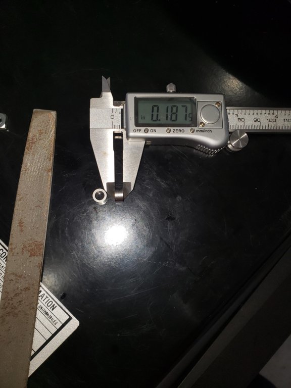

Would this job be much easier if you made new steel bushings or some magnetic stainless?
Turboflash
- Mar 18, 2019
- 2,907
- 2,918
- 1,113
- Southern MN
IMO, no. Shortening the bushings is easy. It's getting them out that makes you cuss.

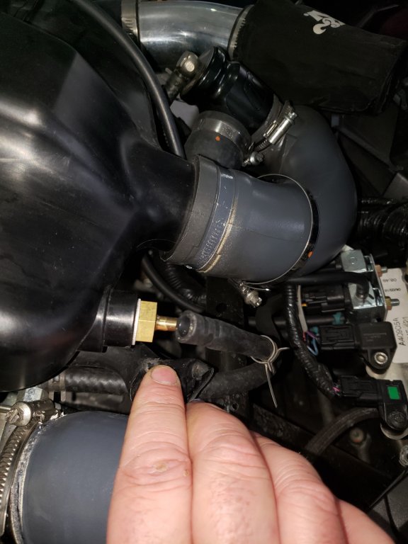

If I recall correctly, you slide the brown connector back and then squeeze the gray parts as much as you can and it will release the line.How do you remove the fuel line from the rack? I can't for the life of me get it off. I've had it off before, can't recall it being this tough.
Turboflash
- Mar 18, 2019
- 2,907
- 2,918
- 1,113
- Southern MN
Yes, slide lock out of way, allowing you to push in on grey pad. It helps to simultaneously push the fuel line in (like you're trying to push it on). That takes some pressure off locking mechanism.
DMCTurbo
- Nov 12, 2005
- 2,854
- 2,604
- 1,623
- Val Caron, Ontario
- 2017 Sidewinder XTX LE 137
Ok I figured as much but must not be pressing hard enough. Thanks.Yes, slide lock out of way, allowing you to push in on grey pad. It helps to simultaneously push the fuel line in (like you're trying to push it on). That takes some pressure off locking mechanism.

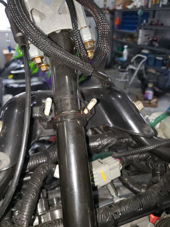

So completed this job. Hardest part for me was removing the fuel line from the rail. For some reason it was a bugger to get off. Removing the throttle body is the way to go. Now to get the new wastegate installed and set up.
