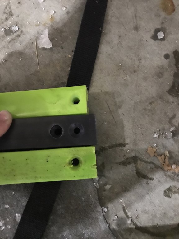

A new problem is the hyfax I took off unfortunately still had a bit of life left in it but I'm playing it safe. The new cat dealer hyfax I got will not butt up against the rail tip. The bottom green is the one I got off the sled, the middle is some garland from denniskirk, and the top is the dealer green. I really want to run the green as it has a nice contrast but again there will be a gap between the rail tip and the hyfax. Yeah I could turn it around and redrill the hole but I just want it to work from the dealer.

Hyfax, you get what you pay for. The OEM ones will fit correctly (unless there is something else wrong). Aftermarket, it's anyone's guess. Tjhey shouldn't be a gap between rail end cap and hyfax.

Yeah the dealer sold me long track lengths, grabbed the correct length today and will pull and put them on tonight.Scratchers - IMO if they're not carbide, they will wear out fast. Also, will you be able to back up with your selection or will they get caught in track or suspension?
