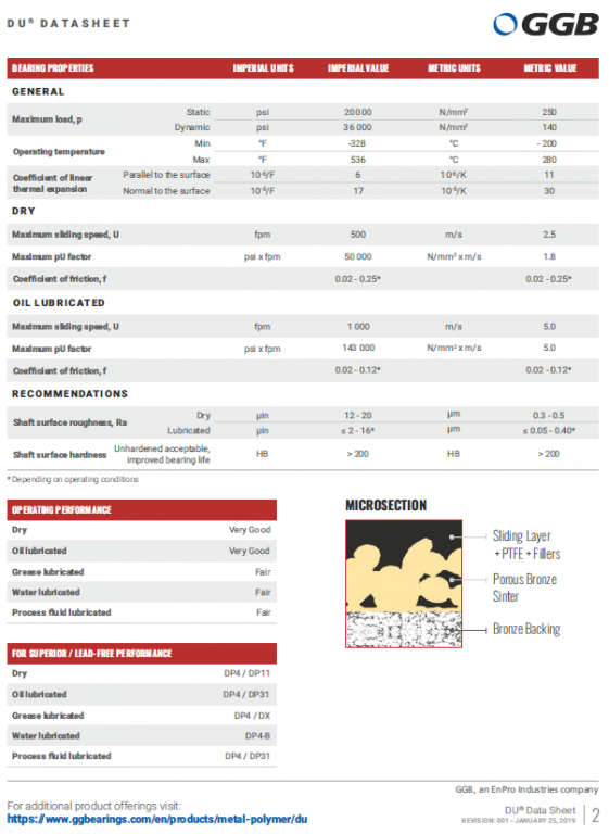

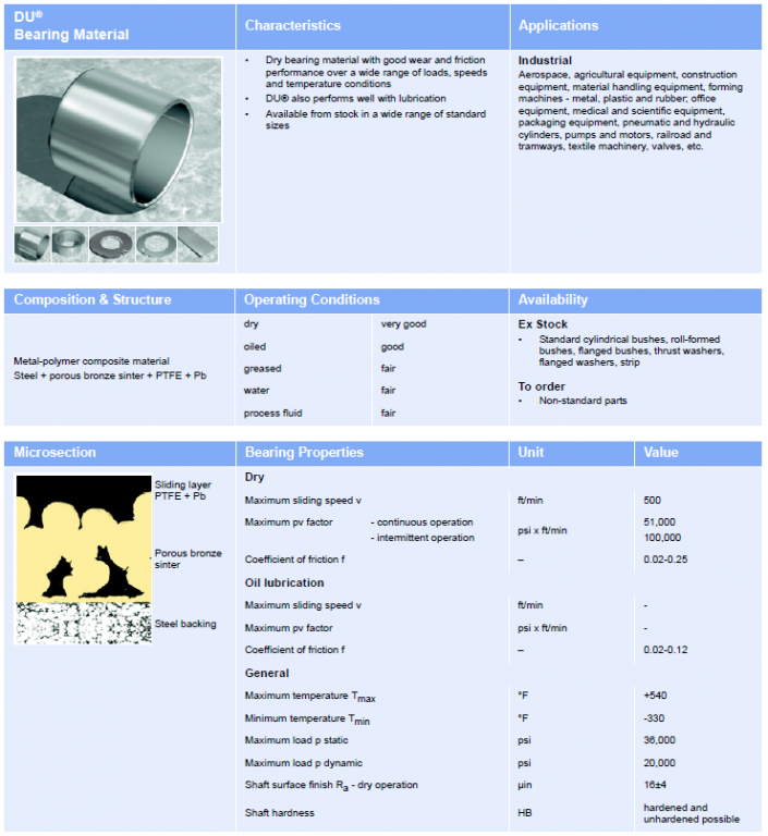

Notice on both of the spec sheets below that they have Very Good listed for running these bushings dry. That is due to the Teflon layer. I realize that a lot of people thing the wear on this bushing is at least partially due to an oiling issue (hence the oil holes in the newer ones). I do not believe this is true... especially with the small amount of time that the bushing actually spins on the shaft.
Here is the spec sheet McMaster-Carr sent me for the #60695K7 bushing.
This is the spec sheet for the GGB DU series bushings (which is supposedly the manufacturer of the OEM ones in the gears). It appears that this data sheet has the static & dynamic ratings backwards since the 20000 & 36000 are flipped. Notice the metric ratings listed to the right. The static rating is higher.
