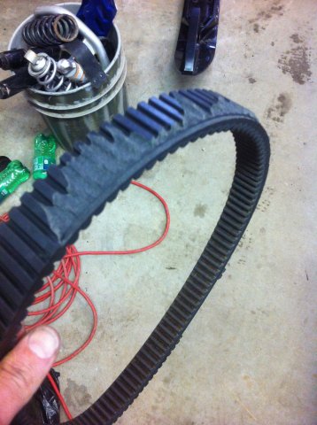

I have had better response with the Gates Carbon belt than the 8DN. Was getting a lot of belt slip with 8DN. Went to change helix wrap today back to trail wrap, and noticed missing top cogs of Gates with only 200 miles on it. Didn't even notice it while riding last time. Looks like it delaminated along one side along about 1/3 of the length of the belt. I put 1200 miles on my list 8DN with no issues whatsoever, other than the belt slipping. I will be calling Gates as 135 HP should not cause the belt to come apart

That sucks. Wierd it is top cogs. Defect you think?I have had better response with the Gates Carbon belt than the 8DN. Was getting a lot of belt slip with 8DN. Went to change helix wrap today back to trail wrap, and noticed missing top cogs of Gates with only 200 miles on it. Didn't even notice it while riding last time. Looks like it delaminated along one side along about 1/3 of the length of the belt. I put 1200 miles on my list 8DN with no issues whatsoever, other than the belt slipping. I will be calling Gates as 135 HP should not cause the belt to come apart![]()

I think so.That sucks. Wierd it is top cogs. Defect you think?
What the! Definitly a defect. Never saw anything like that. Bet they will give you a new one. Maybe two!

I hope so. Will be calling Gates tomorrow. C12's are too expensive to have that happen in 200 miles at 135 HP, and I was easy on it for break in. I didn't even know it starting delaminating until I changed the secondary wrap. sled performance didn't change noticeably (95 MPH) with it like that.What the! Definitly a defect. Never saw anything like that. Bet they will give you a new one. Maybe two!

Talked to Gates today, and warranty processes pretty painless. Fill out the warranty claim info on the inside of the belt sleeve and send a check for $10 and the warranty claim with your proof of purchase in to Gates, and they send you a new belt
Other option if you bought locally, go through the dealer that sold you the belt.
Sure is refreshing to have manufacturers stand behind their products. Glad I chose Gates.
Dayco is same but $15.
