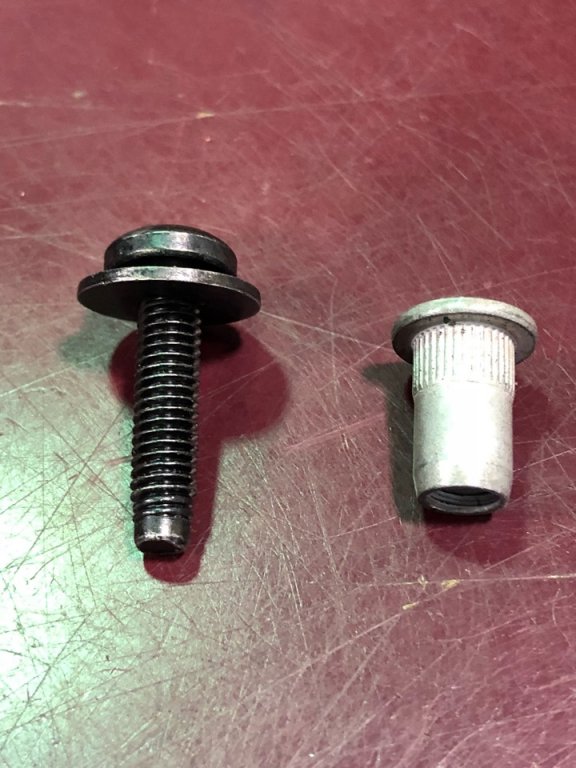

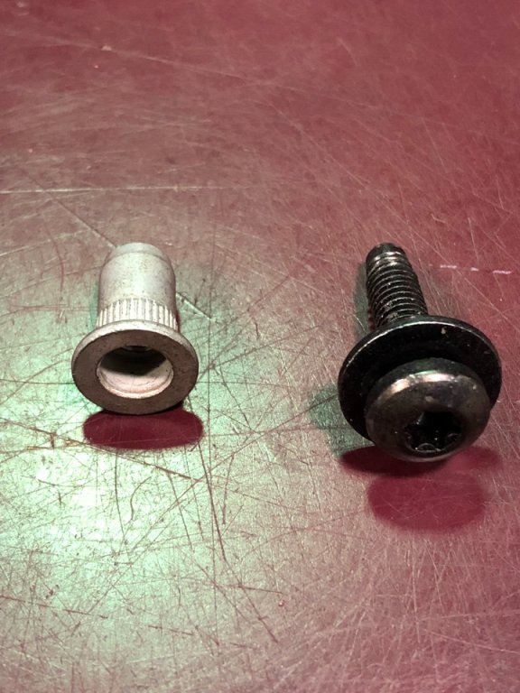

They are 6mm and coated metal,this is what is use on all new GM trucks to install mud flaps. I get them from work and have the tool to install,they don’t rust that I have noticed for years now .Hi Hammer70
May I ask what size rivnuts you used and SS or Aluminum?

They are 6mm and coated metal,this is what is use on all new GM trucks to install mud flaps. I get them from work and have the tool to install,they don’t rust that I have noticed for years now .View attachment 139882View attachment 139883
Wow thanks
I assume 6m went into the thicker metal without issues
