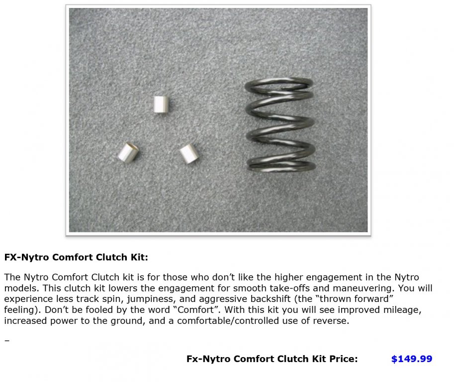

Reviving an old thread but researching the SB clutch kit as I plan to add one as part of my rebuild. Seems like the Stage II is the way to go and just do it! Looking for current comments from SB users, comfort only, stage I and stage II.
I ordered the air box modification last week which looks like nine mini air inlets... hoping to find one of their exhausts on ebay or on a parted out sled as well but need the 90 degree deflection so maybe wont work on my rack equipped XTX. I have been on a 1998 VMAX XTC 700 redhead since 2000 and look forward to my Nytro, I actually like all the tweaking as it dials things in as you learn about weaknesses.

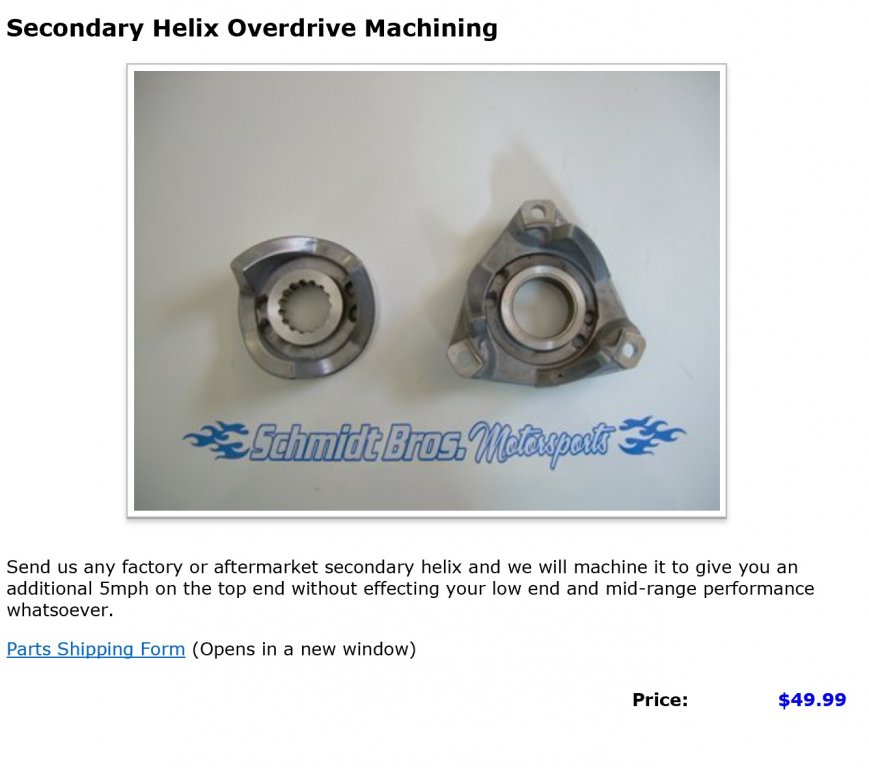

Learning more now about the different clutch kit approaches for our Nytros. Apparently the SB used a smaller diameter roller and softer spring to reduce the engagement RPM and improve response mid through high range. If you have them machine the primary sheaves they will close closer pushing the belt higher creating a larger diameter "gear" effect equaling faster top end. Ulmer uses the stock roller diameter and supplies new arms with different weight options and a lighter spring to improve response and allows you to set engagement RPM via changing the arm weights. Then there are the Heel Clickers that have a patented extra "bump" on the arms creating two reactions from the same arm depending on where the roller is resting on the arm based on RPM and allowing the different weight adjustments (sounds cool). No price listed on their web but found them for $240 on another site... All seem to adjust the secondary with their own helix "angle" and spring rate to allow a smaller diameter "gear" at higher RPM and hence faster. I think I have things right, perhaps not, all very interesting... for me I want to install it and ride it without a lot of fiddling, not doing daily race setups so happy with the SB primary as a starting point test.

You will like it. I have the stage 2 in my sled and it made my sled a new beast. Engagement is super smooth and it pulls like a train.Learning more now about the different clutch kit approaches for our Nytros. Apparently the SB used a smaller diameter roller and softer spring to reduce the engagement RPM and improve response mid through high range. If you have them machine the primary sheaves they will close closer pushing the belt higher creating a larger diameter "gear" effect equaling faster top end. Ulmer uses the stock roller diameter and supplies new arms with different weight options and a lighter spring to improve response and allows you to set engagement RPM via changing the arm weights. Then there are the Heel Clickers that have a patented extra "bump" on the arms creating two reactions from the same arm depending on where the roller is resting on the arm based on RPM and allowing the different weight adjustments (sounds cool). No price listed on their web but found them for $240 on another site... All seem to adjust the secondary with their own helix "angle" and spring rate to allow a smaller diameter "gear" at higher RPM and hence faster. I think I have things right, perhaps not, all very interesting... for me I want to install it and ride it without a lot of fiddling, not doing daily race setups so happy with the SB primary as a starting point test.

Found this thread on page 14 but wanted to post end of last season impressions on the SB mods I made. One word... FANTASTIC! With the quiet clutch / primary clutch kit, air box breathers I now have 2800 rpm smooth roll on with great midrange pull 45-65 mph (and throaty sound like you flipped the air cleaner over on your Dads V8 in high school... Lol). The steering pins and steering shim removed that play we all have so touch the bars and the skis move, sweet on the trails on the power out exits when you feel your skis bite like on rails (the Bergstrom set up was key there too). The block off plate was a great add, dropped 40 lb of ice build up, and the quality of the plate was first rate, worth the money IMO vs messing around trying to fab your own. Lastly the rear suspension shims and high tolerance plastic collars tightened up the ship back there. Next is an exhaust upgrade. Thanks Chris for making these mods for our Nytros, keep up the great work.
