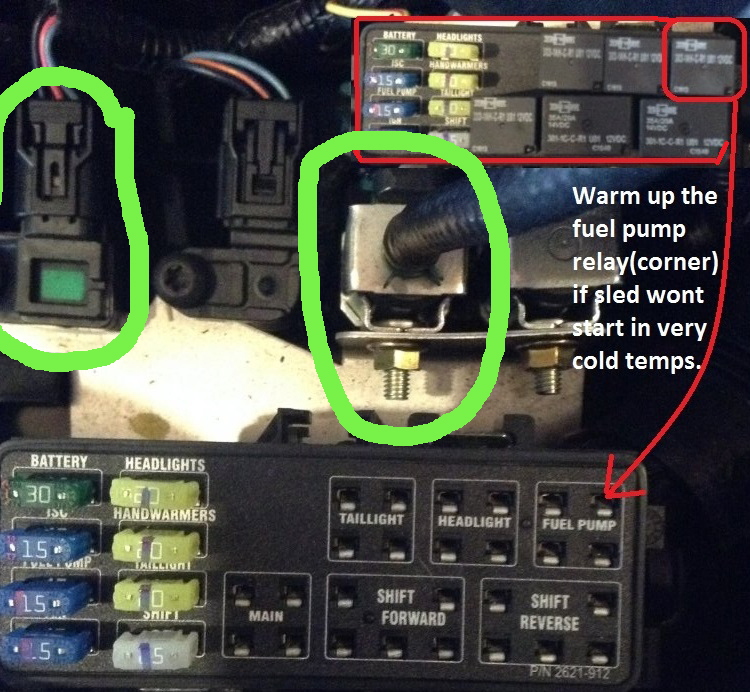

The Green circled items are the valve and sensor for the boost. Your tubes can get water in them from condensation and then the sensor throws a code 26. You would be surprised the amount of water in the tubes along with some blow by oil. To fix the error we took both the sensor and valve inside overnight to dry out and drained all the water out of the tubes and intercooler. In very cold weather the water freezes and plugs the sensors. Try this before spending $200 on a new sensor. It took about 15 miles for the error code to clear.
