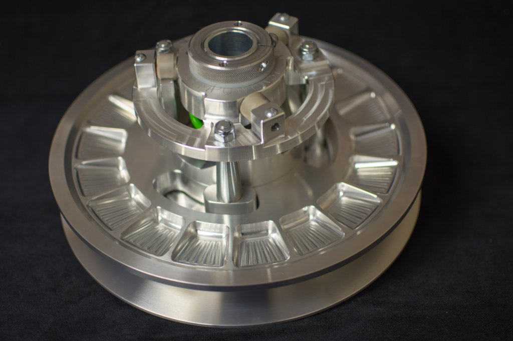

Good idea to put this all in one thread. I'm done with the stock secondary. This will be the last weekend I ride with it. Bit the bullet today. Should arrive next week. I'll need to do some helix/spring testing but I will post results here.
- 3,361
That is PRETTY! What is that & how much? I would take that off & sleep with it every night...
Shagnos
$700 is a big pill to swallow for something that should work from the factory.Good idea to put this all in one thread. I'm done with the stock secondary. This will be the last weekend I ride with it. Bit the bullet today. Should arrive next week. I'll need to do some helix/spring testing but I will post results here.
Shagnos
Have seen this and $350 for a bushing and 3 rollers is crazy!!Just thought it would be a great idea to keep all clutching improvements and testing under one roof so we can easily track the improvements.
You're certainly right. But the season too short for me to keep messing with stock secondary. I've used stm clutches on my past turbo sleds and the perform fantastic. The stock secondary is quickly showing it's weakness in within low miles and stock boost. I'll be running my sled boosted and would likely make all the known problems show up that much faster.
