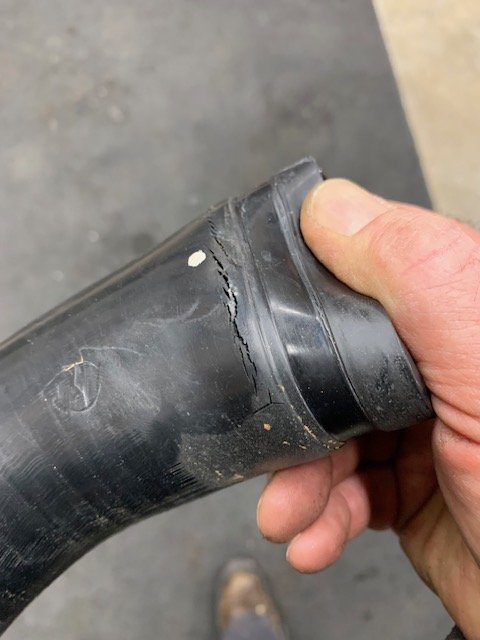

60 Miles on this hose, not sure what supplier their going thru now for the boost hoses but they are complete garbage. Got one cracked all to crap and the other has bulges and balloons happening. Seen other pictures with the same thing happening, should have taken pictures prior to me taking it off! It looked like it was blown just sitting there.

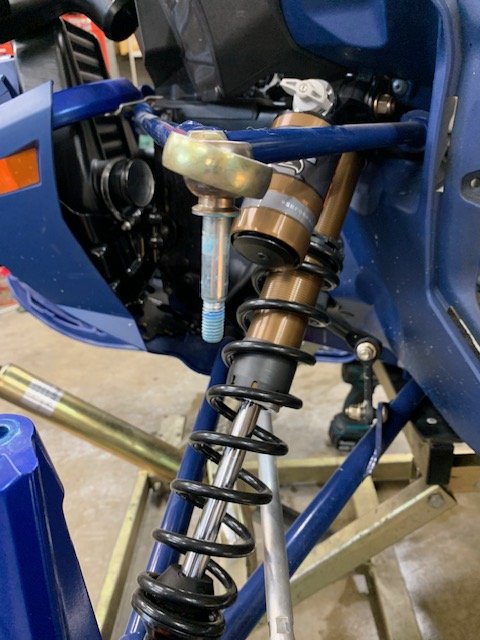

Found this Torx bolt loose on top spindle him joint on the stand today! I just happened to stumble upon it and could move it up and down 3/16" of an inch! I took it out with my fingers!!! It had what looked to be powder blue loctite on the threads but it obviously did nothing to hold it together. Can you imagine if that would have come off running WFO down the trail! And it would have had I not caught it! It was only being held in by a thread or two! WTF Cat assembly crew, get your #*$&@ together!
Checked the other side and it too was far from tight! No telling what else I might find, but none of the bolts, nuts and clamps are what I would call tight. Some loose, some only snug. You got to go thru every inch of the machine unless you want it coming apart. I found the tension would spin around and around on the roller bolts, and in typical Cat fashion the two bolts although loctited, bottom against each other and dont really tighten up totally, they still haven't fixed this issue after all this years! I tack welded them both, so they can go no where and the chain case will stay intact.

Have 2 new 2023 srxs. Both had charge tubes looking like that from brand new. Apparently they had a bad batch. So far that's all I've found...The onus is on the factory to use quality parts, get the nuts, bolts clamps tight from the start. All the dealer does is put the skis on and set it up. I've ripped my 23 down to go thru it completely.

Same thing here, brand new 2024 zr9000 rr and the lower intercooler hose all weather checked both ends by clamps and coolant leak someplace by muffler area...0miles on it, pulling sled completly down this weekend and going thru it clamp by clamp and bolt by bolt.The onus is on the factory to use quality parts, get the nuts, bolts clamps tight from the start. All the dealer does is put the skis on and set it up. I've ripped my 23 down to go thru it completely.
