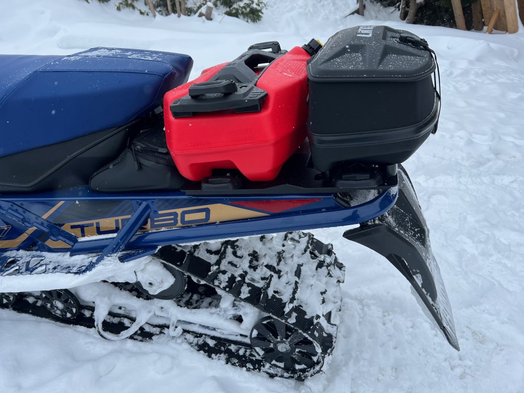

600 Mile Update
Here is a quick update after about 600 miles
- The shaper bars are not working out. They are fine as far as turning goes - but they dart like crazy - especially on a well used trail. Going to put on a pair of 9" Deuce bars this week and see how that goes.
- I need more preload on the rear springs. When I am carrying gas and the trail is bumpy - the rear end is too soft even at setting #3. I'll order heavier springs or try the BOP cam that adds a 4th position.
- I installed the BOP ROV bypass - but didn't connect it to the valve cover, I made a loop out of it and ran it down under the right footwell. DO NOT DO THIS!!!! I lost more than 1L of oil on a 90 mile run. Travis confirmed you must connect it to the vent cover or you will lose oil. I consider myself lucky here. The oil pressure light did not come on and the coolant temp stayed normal even though I ran a long time down 1L of oil. I changed the oil right after this happened and sled is running fine with 200 miles since this happened.
- I have tightened the chain twice now - both times I could turn the adjuster bolt in about 2.5 turns. Finger tight and 1 turn back both times.
- I have virtually zero belt dust and very minimal mung/oil on the air filter or in the airbox. Clutches are running cool.
- The UNT Linq bracket is great (see pic). Gives me lots of storage options and the small Arctic Cat bag can stay in place all the time.
- Annoying squeak coming from brake area. Sometimes the brake squeaks, sometimes I hear the squeak during a real slow turn. It's almost like the brake drags even when not being used - during a low speed turn.
- Love the power and the engine braking and the handling other than the darting. If the Deuce bars don't work out - I have a pair of Pilot 6.9's on my Backcountry that I can try.
Headed back up to Sturgeon Falls area later this week for another couple hundred miles of fun.
