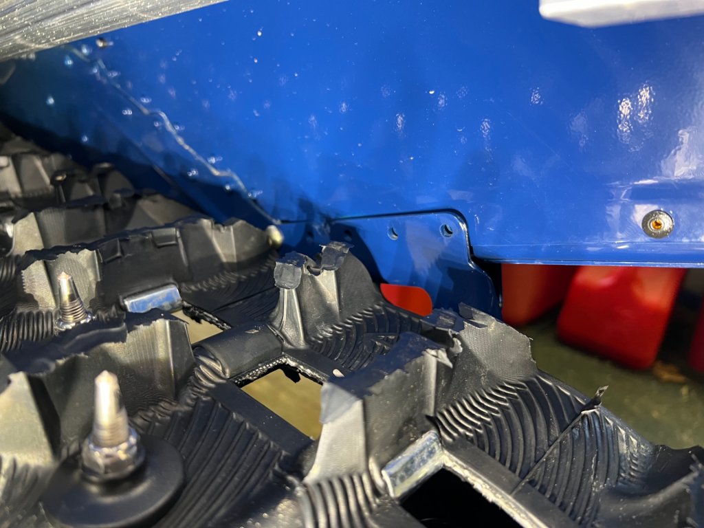

When installing the studs - 0 miles on sled - I noticed 4 structural rivets missing inside the tunnel on the rear suspension bracket (see picture). Dealer fixed it for me right away.
