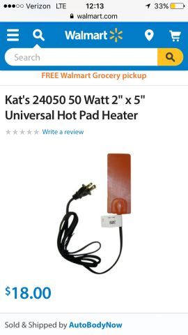

I'm going to put mine on the oil tank right next to the muffler
I'm sure there will be some heat transfer

Just spoke with the distributor in Winnipeg - he suggested the 75 watt unit (pad size is 2"x3") if you wanted more heat go for 125 watt (pad size 2.25"x3"). Trick is the surface needs to be flat, no textured surface or curves). I expect we have a surface that size on bottom of oil pan but I'm not 100% certain).

I changed my order and went with a 250 watt 3.75" x 4.25" pad
Hope to install it this week

Installed my oil tank heater - located at bottom of back side (next to muffler). Seems to work well - will certainly keep oil warm and heat does get transferred to bottom of motor. That said I did notice there is potentially a spot for an in line rad heater (had I know I would of tried that). If you remove the access panel to get at oil filter at bottom of the sled you will see the spot - it's tight but I think it will work. The in line heater will do a better job of keeping the motor warm on those - 30C mornings.
