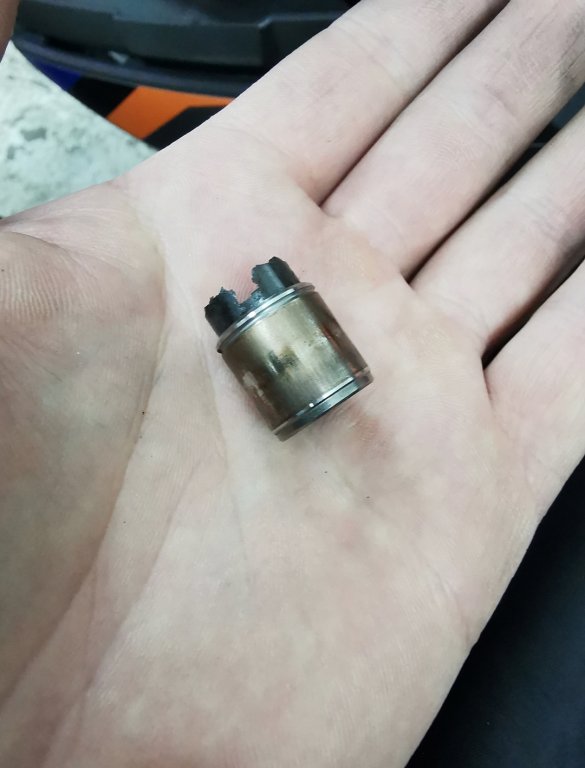

I drove 2,400 km. Today I started to carry out maintenance. I removed one of the primary rollers and saw that the sleeve was worn out. I want to install all the primary clutch rollers from turbo dynamics at 14.8 mm. Do I need to change something in the settings?
Sidewinder B-TX LE 153 2020 model year.

No, just install.I drove 2,400 km. Today I started to carry out maintenance. I removed one of the primary rollers and saw that the sleeve was worn out. I want to install all the primary clutch rollers from turbo dynamics at 14.8 mm. Do I need to change something in the settings?
View attachment 167705View attachment 167706

If your roller has worn right through the bushing, be sure the pin surface isn't damaged.
I'm finding most Winders stock, and up to 250HP can get close to 5-6000 miles on the original rollers.
I've switched to the GForce, I like that they are wider with the nylon washer from the former Yamaha clutch. They also cost less than the Yamaha roller.
I haven't accumulated enough miles yet on the Gforce to see if they last longer.
I'm scratching my head as to why Yamaha would make room for a wider roller, but instead completely waste it with a wide washer(there was nothing wrong with the thinner washers).
If Yamaha made the same roller, but wider they would for sure last longer IMO.

I checked all the fonts, they are fine, I didn't notice any damage.If your roller has worn right through the bushing, be sure the pin surface isn't damaged.
There is also wear on other bushings, but less.
Maybe add some grease to the bushings? Do need to lubricate the variator at all? Or only purging with compressed air?
