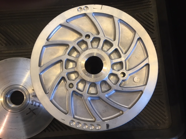

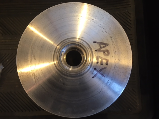

I took a couple pics to compare the fixed sheave diameter between the Apex and Sidewinder primarys...they are the same diameter. The second pictures shows the Apex fixed sheave overlaying the sidewinder fixed sheave.
As stated by the experts the diameter increase is only on the moveable sheave.
The difference in diameter is another reason why we have switched back to the previous style Yamaha primary.
