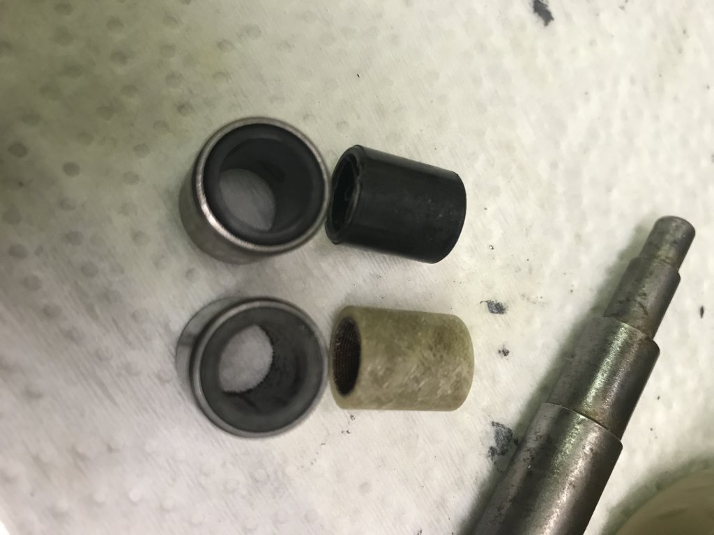

So these bushings are duralon from Yamaha,i wonder why Yamaha just does not install them on all sidewinders?View attachment 147675 View attachment 147674
Ran these duralon bushings in my 14.5 rollers with cat green set at 9-1 for 700 miles at 290hp in upper Michigan this weekend no problems . Stock bushings in sidewinder wouldn’t have made it 200 miles before . Would recommend it to anyone having bushing movement problems.
