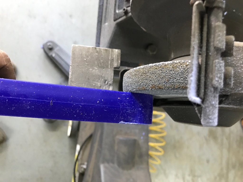

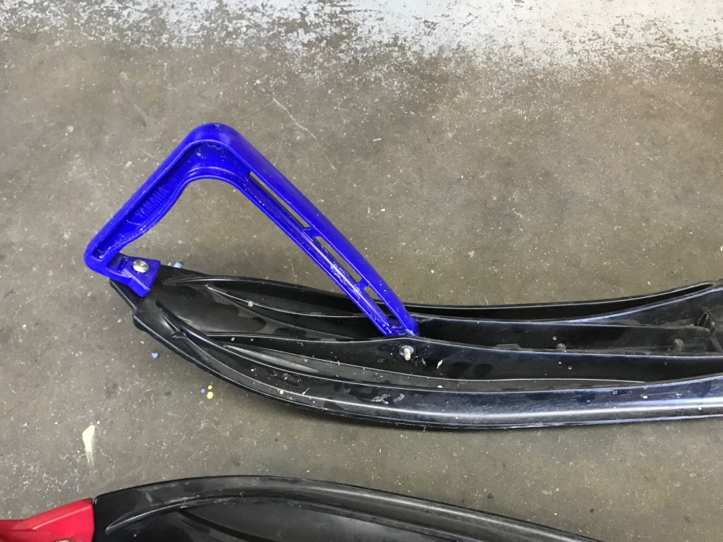

The tuner 3 loops actually fit the cat skis rather easily. Just reduce the width of the loop where it fits in the saddle, drill the holes out in the cat ski and use the tuner loop hardware.
Note my fit up pic just has the cat hardware.
View attachment 130856 View attachment 130857
leave it to you Travis...always a solution!
