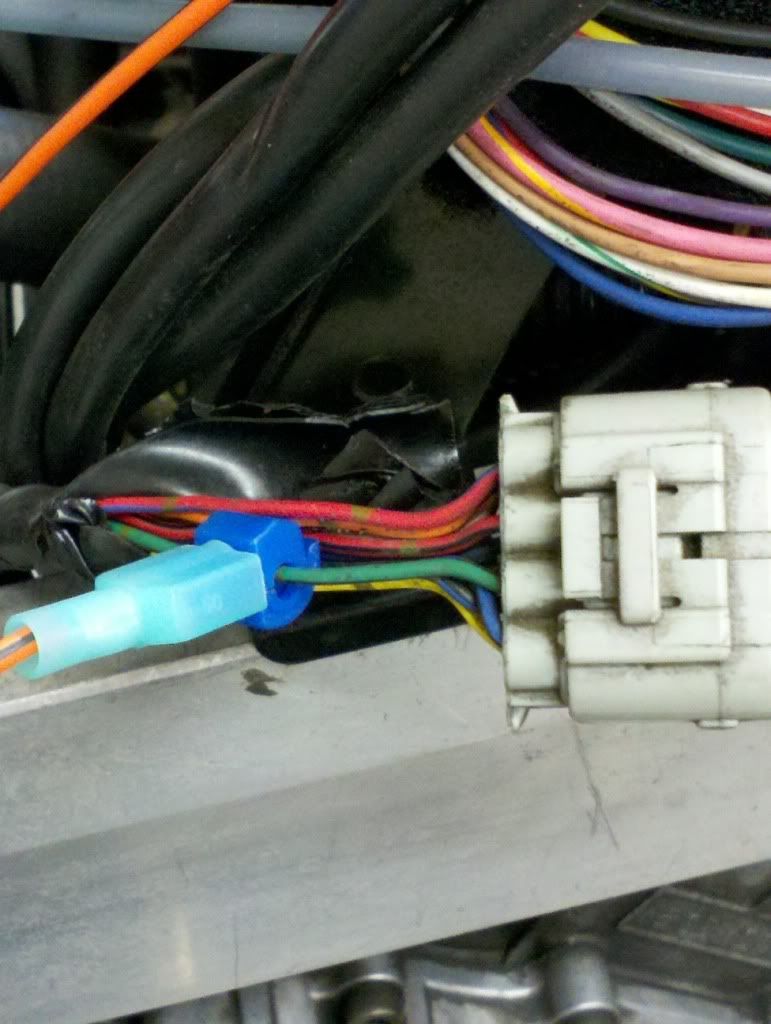

It was the GEMS a REALLY easy fix, simply cut the supplied injector harness off and tap the injector with a 3M wire tap 14-18 gauge into the injector wire BEFORE the gems on the main harness. Here is a picture of the wire I used which I think it is injector 3.
Everything works like a champ!

I actually checked on getting that plug rather than the injector plugs but would only sell in very large quanity. You'd be better soldering that wire to it.

This was a test to see if it would work, I will button it up properly before use.
Not a fan of soldering I must be bad at it, had more soldered connections fail (solder cracks under vibration) then using good crimp or other electrical connectors.
