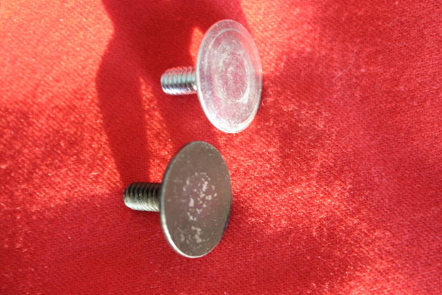

Mark O said:
Thanks for the link Bob. After looking at the websight & pictures, am I correct in my assumption that their "aniti wear pads" are just a simple carriage bolt with a locknut?
NO they are not a simple bolt ...they are made specifically for your track ..wider and flatter than a carriage bolt and stainless steel...I wouldn't use carriage bolts they aren't much cheaper anyways and not made for this application.

Mark,
I believe the SLP bolts are actually a little flatter on top than a standard carriage bolt. I bet 1/4" carriage bolts would work fine. The SPL bolts come with nylock nuts but a std 1/4-20 nut with Loctitie would probably work fine as well. I ordered a set of SLP anti-wear pads, should have them in a few more days. I'll post with more info after I get them.
I looked at SLP's bolts, they look like a carrage bolt but are larger diamater heads and they are flat. I think they would work better than simple carrage bolts.

The SLP's are carriage bolts just stamped to flatting them a bit. If you go to Ace hardware you can pick up elevator bolts which are about the same thing only completely flat on top.
