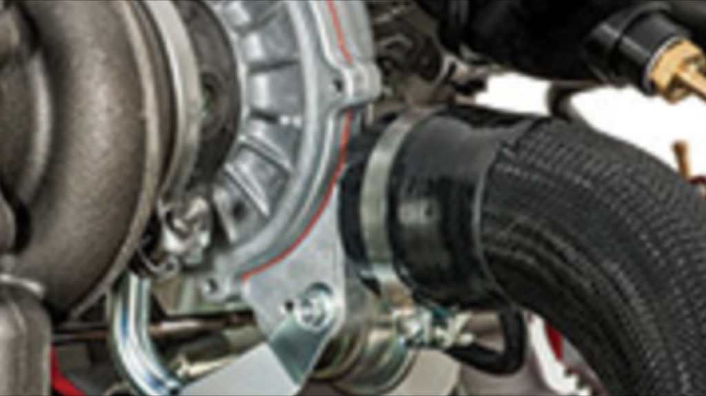

Hi guys , need your help , ltx le , 1000 km error code sr26 , all stock , wont let me go past 7800 rpm , any ideas !!
Just drove 6 hrs home , cant ride it at half throttle ! everything looks great ???
Any after market parts on the machine?
Pstn head
Sr26 code says its "upstream pressure sensor (PC) according to my addendum diagnostics codes, please anybody correct me if I'm wrong

Boost leak check intake boots very carefully. Also check for popped off vacuum linew going to sensors. Check for atmospheric pressure sensor icing up. That will cause it.Sr26 code says its "upstream pressure sensor (PC) according to my addendum diagnostics codes, please anybody correct me if I'm wrong
Please check hoses and clamps. We had a customer get the same code when the hose to the turbo poped off. Have also see many of these clamps not very tight from factory.
If I was at shop I would take actual pic but these are what I came up with off the net.
