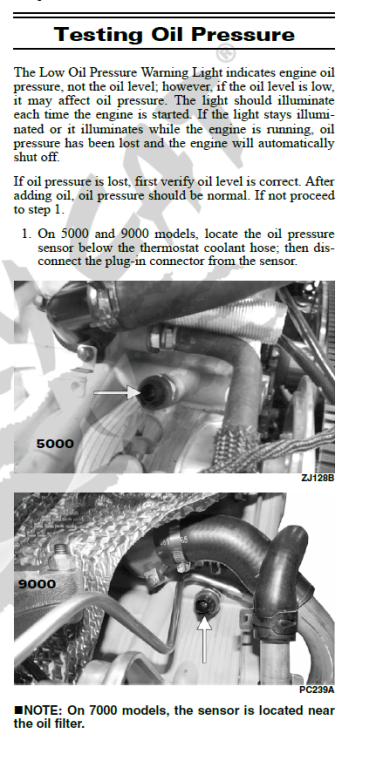

I don't have an actual sidewinder manual, but going through the Viper manual that I do have as well as many of the tech update materials that list fault tables, none of them have your 0524 in the table. They do have 0522 and 0523 which are both for the Oil pressure sensor, not switch. From that and the logical assumption 0524 would be related to 0522 and 0523, I'm pretty confident that the three wire sensor is the one that is being used for fault you are experiencing. I suspect the switch is only there to drive the dummy light on the CAT cluster.
I'm an engineer for a major engine manufacturer who deals with diagnostics daily and the way our oil pressure protection logic works is a table that varies minimum oil pressure with engine speed. The faster the engine is revving, the higher the oil pressure needs to be to avoid setting a fault. I'd bet that Yamaha is doing the same in your sidewinder ECU.

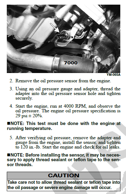

I still go back to my recommendation from last year and suggest you get an oil pressure guage on your engine so you KNOW it's a sensor problem vs a true lube system problem. There's a procedure in the Service Manual for testing this. I don't have it for a Sidewinder, but here's the one for a Viper for reference.

That's great info. I have a manual oil pressure kit. I will try it. I agree the switch is for what we call the "genie light" from back in the 2 stroke days. Thanks so much.
