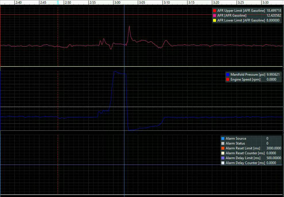

![9cd818b2b7b3e95b5e29023fc9bdebfd.jpg](/proxy.php?image=http%3A%2F%2Fuploads.tapatalk-cdn.com%2F20161215%2F9cd818b2b7b3e95b5e29023fc9bdebfd.jpg&hash=2707439009d00b4bdfe2c8b6ba6ca366)
This is the stock tune with stock muffler... Air fuel is just right.

The only way an aftermarket pipe can work with a stock ecu safely is that it offers a modest hp gain and flow is restricted vs higher flowing pipes like the td turboforce td super quiet.
This is why we offer tunes to at least correct air fuel but might as well jump to ecotrail. Or enjoy the stock sled.
