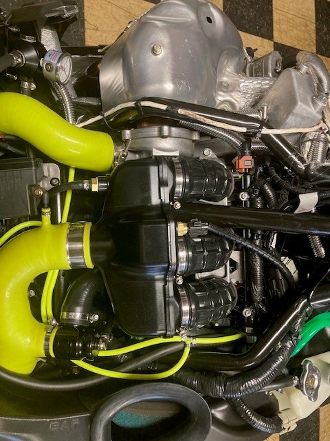

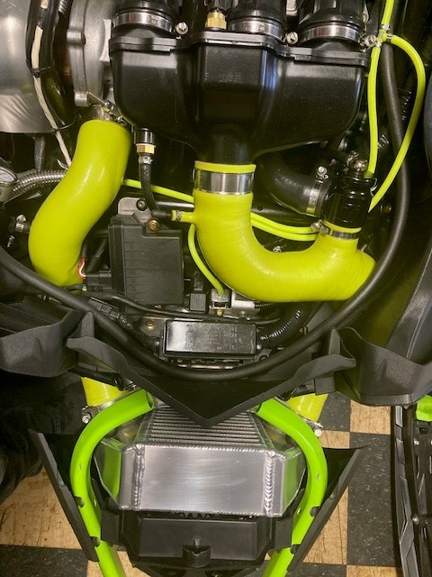

What did you do on the backside for air flow?
Dave from Turbor said he doesn't drill the bulkhead so neither did I. There's enough space between the intercooler and the bulkhead to allow air movement.

Personally I didn't consider the PEFI as it is only .75 thicker. The turbor is 2.5 thicker.

Comparing logs from my last day out with the stock intercooler to today's with the Turbor intercooler, (similiar ambient temp), IATS are down 25 degrees or so. It'll be interesting once I can get a long pull in to compare with last year's IATS.

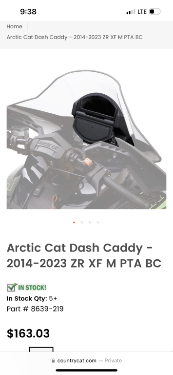

I had no idea this existed! Similar to the dooooo dash box by the looks. Love that your GPS is mounted to it.

you can even drill a hole in bottom that allows heat to come up from engine keeping contents warm. GPS fits perfect.

Not to hijack DMCTurbo thread look here..I had no idea this existed! Similar to the dooooo dash box by the looks. Love that your GPS is mounted to it.
Arctic cat dash caddy
Has anyone added the arctic cat dash caddy to a sidewinder? Looks as if it will fit just looking for a better gps mounting system and it gives ya some storage. Running sport windshield also. Any insight...
